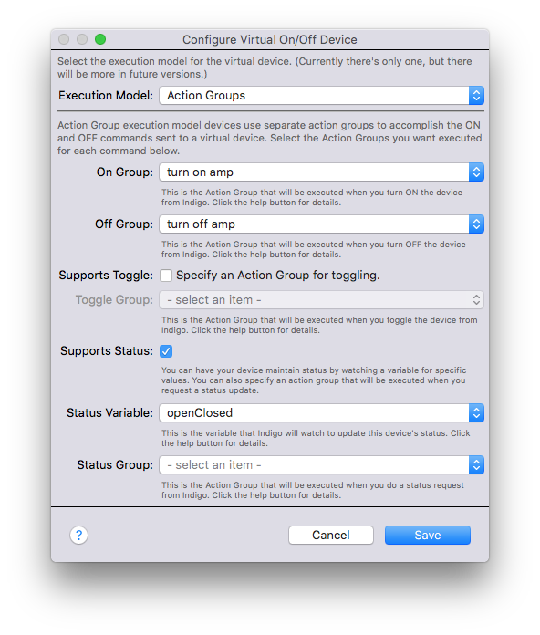

Action Groups
In order to make virtual devices simple enough for non-technical users to use them, we started with the Action Groups execution model. This means that you specify an action group to execute for each of the major tasks that a ON/OFF Device can perform: turn on, turn off, toggle, and get status. Here's the config dialog for Action Groups:
The first thing you'll select are the action groups to execute when the device is turned on and off. So if you click the Turn On button or select the Turn Off action in the Control Light/Appliance action, for example, the appropriate action group will be executed. These two are the minimum requirements for this type of virtual device.
Next, you can specify an action group that will toggle a device - so if there's some way for your action group to determine at runtime how a toggle should work then you can specify it. If not, just leave the checkbox unchecked.
Automatic State Maintenance
Finally, your virtual device can maintain a state if you like. But, Action Groups can't directly manipulate state you say, right? Well, that's true. However, Action Groups can modify a variable. So, we've allowed you to select a variable and we'll monitor that variable for any change. If the value of the variable becomes “on” (or “true”, “open”, “1”, “yes”, “enabled”), we set the state of the virtual device to on. If the variable becomes “off” (or “false”, “closed”, “0”, “no”, “disabled”), then we set the state to off.
If you set the value of the variable to anything else, we'll set the state of the device to whatever you entered for the variable value AND we'll mark it as having an error. This will cause the device to turn red in the device list to help show you that there's a problem. (Z-Wave devices will do this as well and eventually INSTEON devices will too).
So your device's state will mirror the value in the variable. You can also specify an action group that will be called when you request a status update via the UI or via an action.
Note: if you don't enable Supports Status, your virtual device will always show as being “off” in the UI and triggers that watch for state change will never fire. That may be fine for your particular needs so we made it optional.
