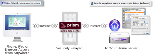

Your purchase of Indigo 7 includes an Indigo Up-to-Date subscription, which itself includes reflector access. If you have an active Up-to-Date subscription, you can have a reflector!
Reflectors provide:
Activating a reflector is fast and easy. First, make sure you are running Indigo version 7.0.0 or greater(both client and server – check the About Box). Next:
Indigo→Start Local Server… menu item.Require authentication checkbox and enter a User name and good Password. You will *definitely* want password authentication on since you are about to enable access to the Indigo web server from the Internet.Enable anywhere secure access checkbox.Activate Reflector button.A browser page will open to the http://www.indigodomo.com/account/codes/ page listing your registration codes.
Sign up link below the login form. When you create an account, we'll send you an activation email that contains a link to activate your account. When you click that link, it will switch you back to your browser and open the reflectors page. If for some reason it doesn't, switch back to Indigo and click the Activate Reflector button again and it will.Once on the registration codes list page, you'll see a message to click the Create Reflector link next to your Indigo registration code. Click on that link and you'll switch to the Reflectors page with a form field to enter your reflector name. When you submit that we will create the reflector, activate it, and take you back to the codes page which will show your reflector activated.
Lastly, switch back to the Indigo Start Local Server… dialog. It should now show that the reflector status is activated and will show a link to your new reflector URL. Press the Start Server button and that is it – Indigo will restart and automatically connect to your reflector! To access from the web, simply go to https://YOUR-REFLECTOR-NAME.indigodomo.net/.
