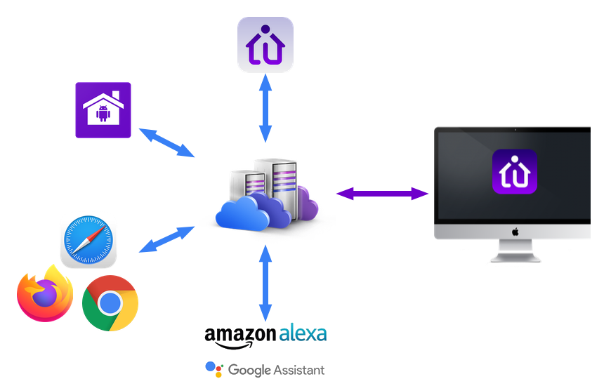

Reflector Flow Image
Reflectors provide:
Activating your Reflector
