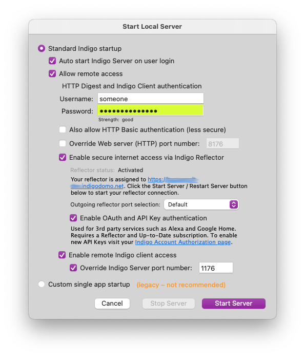

Starting Indigo Server
- Double click the
Indigo 2022.2application (/Applications/Indigo 2022.2.app). - If this is the first time to run
Indigo 2022.2on this Mac, then press theStart Local Server…button in the connection status window. - If you want to reconfigure the Indigo Server on a Mac already running Indigo, then select the
Indigo 2022.2→Start Local Server…menu item.
Standard startup mode
Custom single app startup
Starting the Server
