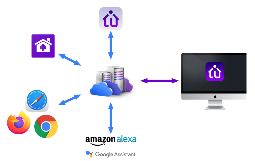

Reflectors provide:
- Personalized easy-to-remember URL when using Indigo Touch for the Web
- Indigo Touch for iOS (iPhone, iPad, etc.) and for the Web can access your Indigo Server from anywhere in the world
- Indigo Touch for iOS enabled – automatic switching between local Bonjour access and remote reflector access
- 3rd party services like Amazon Alexa can get secure, authenticated access to your Indigo Server to open up a broad range of integration possibilities.
- Complete remote access solution (much more than just a dynamic IP address mapping service)
- Fully encrypted (256-bit) communication
