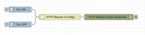

The following example shows how to configure a Node Red flow that uses the Indigo Web Server (IWS) API to operate a lamp device. The example is only meant to show how to use a self-signed certificate and public key to enable the flow to connect to the IWS using https instead of http when using the IWS on a local network via 10.0.1.123, 127.0.0.1, or localhost (using the API via the Indigo Reflector Service uses a different CA-approved security certificate and the flow is configured the same as it would be using any API via https).
Noe Red Image

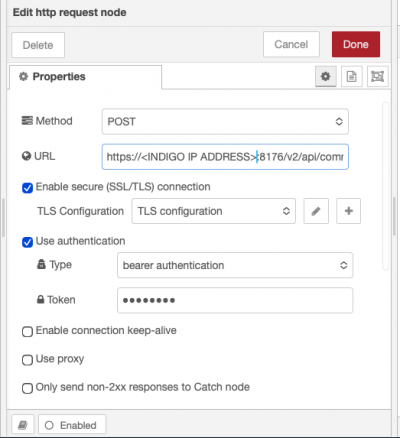

Using the flow via https requires a few settings. Enter the preferred URL to point at the local IWS address 10.0.1.123, 127.0.0.1, or localhost with the URL:
https://<INDIGO IP ADDRESS>:8176/v2/api/command/
for example,
https://10.0.1.123:8176/v2/api/command/
Node Red 6 HTTP Request Node Image
select TLS, and use bearer authentication along with a valid token key (from your Indigo Account Authorizations).
Then, use key and certificates from local files and point them to the certificate and public key files located in
/Library/Application Support/Perceptive Automation/Indigo 2024.1/Web Assets/cert/

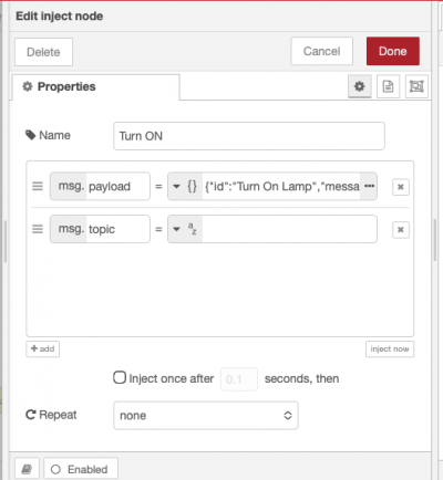

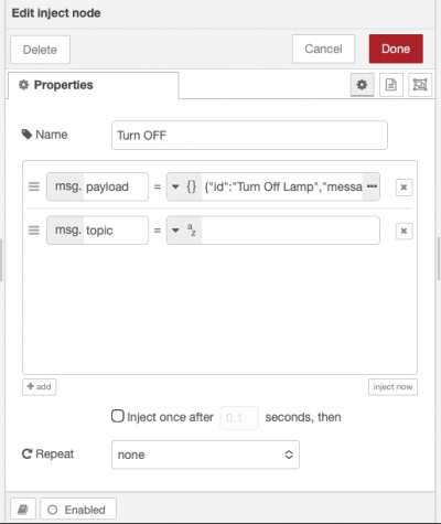

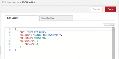

Several other screenshots complete the example:
Node Red Inject Node Turn On Image

Node Red Inject Node Turn Off Image
Node Red Inject Node Turn Off JSON Image

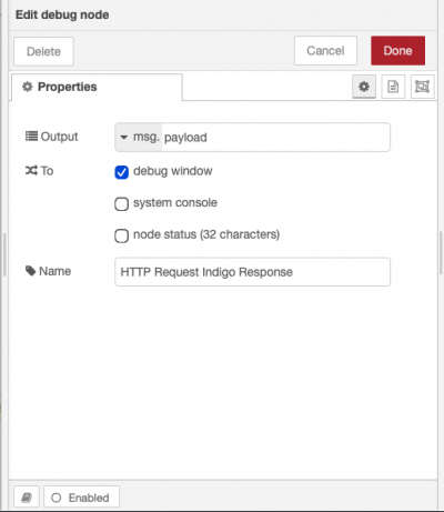

Node Red HTTP Debug Node Image
