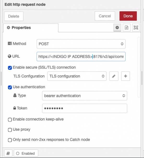

Node Red Example
The following example shows how to configure a Node Red flow that uses the Indigo Web Server (IWS) API to operate a lamp device. The example is only meant to show how to use the self-signed certificate and public key to enable the flow to connect to the IWS using https instead of http when using the IWS on a local network via 10.0.1.123, 127.0.0.1, or localhost (using the API via the Indigo Reflector Service uses a different CA-approved security certificate and the flow is configured the same as it would be using any API via https).
Using the flow via https requires a few settings:
Enter the preferred URL to point at the local IWS address 10.0.1.123, 127.0.0.1, or localhost:
