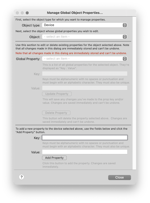

Before using the features of the Global Property Manager plugin, you must first enable it by going to the Indigo client Plugins menu item, selecting the plugin, and then selecting Enable. Once the plugin is enabled, all the plugin's features are accessed via the Manage Global Object Properties… plugin menu item. Once the dialog is opened, you can manage your custom object properties.
1. To add a property to an existing Indigo object, first select the type of object you want to edit. Use the Object Type dropdown menu to select among devices, action groups, variables, triggers, schedules or control pages (devices should be selected by default when the dialog is first opened). You can only add properties to objects that already exist.
2. Select the specific object you want to add a property to from the Object dropdown menu.
3. At the bottom of the dialog are the controls to define your property, set its value, and add it to the selected object. You must create at least a key name, but the value can be empty at the time the property is created. Key names must be alphanumeric, with no punctuation, and must start with a letter. Key names must also be unique within the object itself (you can add the same key name to other objects).
You can use the controls in the center of the dialog to update or delete existing custom properties. You can change a property name, update its value, or delete the property entirely. Editing or deleting a property only affects the selected object. In other words, if you've added a property to multiple objects, you will need to edit each object individually. Changes made using these controls are applied immediately and can not be undone.
