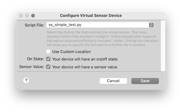

Virtual Sensor Configuration Dialog Image

Script Locations
You can add scripts directly to the /Library/Application Support/Perceptive Automation/Python3-includes folder, or you can point to a script in any location that Indigo has the authority to access. Python scripts that are saved to the above folder will be available in the Script File dropdown menu. Alternatively, you can check the Custom Location checkbox and a field will open for you to enter the full path to the script file.
