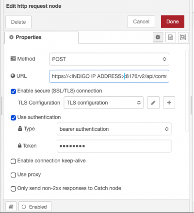

Using the flow via https requires a few settings. Enter the preferred URL to point at the local IWS address 10.0.1.123, 127.0.0.1, or localhost with the URL:
https://<INDIGO IP ADDRESS>:8176/v2/api/command/
for example,
https://10.0.1.123:8176/v2/api/command/
select TLS, and use bearer authentication along with a valid token key (from your Indigo Account Authorizations).

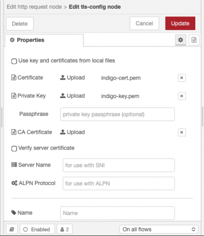

Then, use key and certificates from local files and point them to the certificate and public key files located in
/Library/Application Support/Perceptive Automation/Indigo 2024.2/Web Assets/cert/

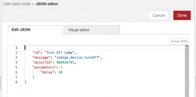

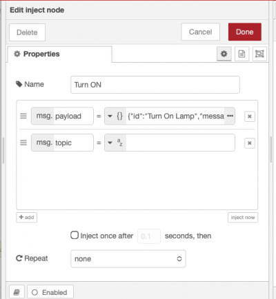

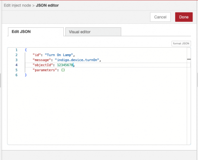

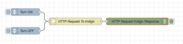

Several other screenshots complete the example:
