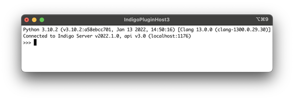

/usr/local/indigo/indigo-host
Connecting Remotely over SSH
What Else Can it Do?
indigo-host -e '
