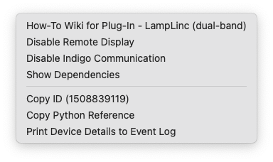

This menu will:
- Take you to the How-To wiki for that device type - if it's a plugin device, it will take you to the help page supplied by the plugin developer.
- Toggle remote display - this tells Indigo whether to show the device in remote clients.
- Toggle communication with the device - this effectively enables/disables the device. If a device is disabled, it will show up gray in the list.
- Open a window that shows all other objects that are dependent on this device. See Deletion Dependencies for more information.
- Copy the unique ID of the device to the clipboard - to assist in writing Python scripts that use the device
- Copy a Python script string that will return an instance of the selected device. It will look like this:
indigo.devices[91776575] # “Living Room Switch” - Print all the information about a device to the Event Log window. It will look something like this:

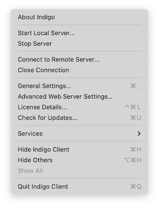

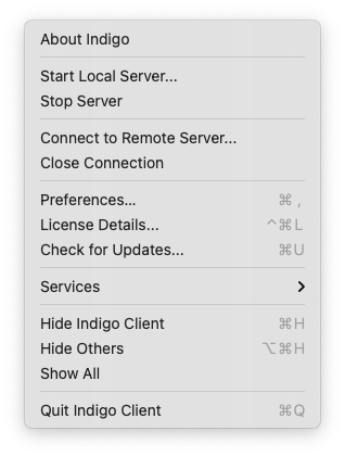

Indigo 2024.2 Menu

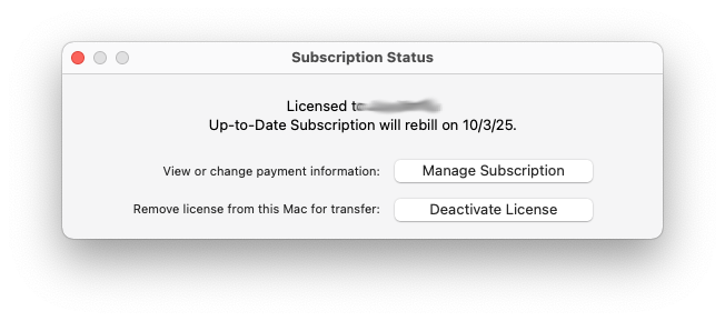

About Indigo 2024.1- this will show the About window which will show what client and server versions you're running and will show your registration codeStart Local Server…- this will open the Start Server dialogStop Server- this will stop the Indigo ServerConnect to Remote Server…- this option will allow you to connect to a different Indigo server or a server running on another MacClose Connection- this will close the connection to the serverGeneral Settings…- this opens the preferences dialogAdvanced Web Server Settings…- this opens the Indigo Web Server Settings dialogLicense Details…- this opens the Subscription Status window that will show you the status of your License and it's associated Up-to-Date Subscription:
Check for Updates…- this will have the server your connected to contact us to see if there is an update available

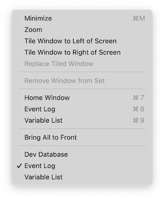

Window Menu
Home Window- this will show/bring to front the Home WindowEvent Log- this will show/bring to front the Event Log WindowVariable List- this will show/bring to the front the Variable List Window
The bottom of the menu will display the list of open windows, where the name of the active database will replace “Home Window”.

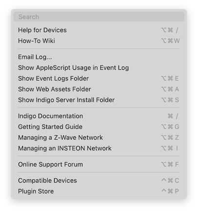

Help Menu
Help for XXXX- this will change slightly based on what window is selected and what's selected in that window - but it will open the default browser to the page in the help documentation for that particular itemHow-To Wiki- this will change slightly based on what's selected - it will open to the How-To wiki for the selected item (if a device is selected it will go to the wiki for that device, otherwise it will just go to the landing page)Email Log…- this option emails some of your event log data to the specified email address. Particularly useful for technical supportShow AppleScript Usage in Event Log- this option prints a list of AppleScripts that are embedded in actions that you have specified. This will help to identify and replace those scripts.Show Event Logs Folder- this option will switch to the Finder and open the folder that contains the Event Log log files.Show Web Assets Folder- this option switches to the Finder and open the folder that contains custom images, text files, etc., that you might want to give Indigo (and others) access to through the Indigo Web Server.Show Indigo Server Install Folder- this option opens a Finder window that displays the folder of the currently running Indigo installation. This will only run from the server machine (you'll receive a warning otherwise).Indigo Documentation- this option will open your browser to the landing page for all Indigo 2024.1 documentationGetting Started Guide- this option opens your browser to the Getting Started Guide, the place where everyone new to Indigo should startManaging a Z-Wave Network- this option opens a browser window to the Managing Your Z-Wave Network document in our Documentation wikiManaging an INSTEON Network- this option opens a browser window to the Managing Your INSTEON Network document in our Documentation wikiOnline Support Forum- this option opens your browser to our support forum - it's very active and is the primary place where you should seek help - we answer questions there very quickly and in fact we have many helpful users that can help as wellCompatible Devices- this option opens a browser window on our new Compatible Devices list that shows which devices and interfaces have been tested with Indigo and includes devices supported by 3rd party pluginsPlugin Store- this option opens your browser to our Plugin Store where you can browse and download hundreds of 3rd party plugins that add functionality to Indigo
