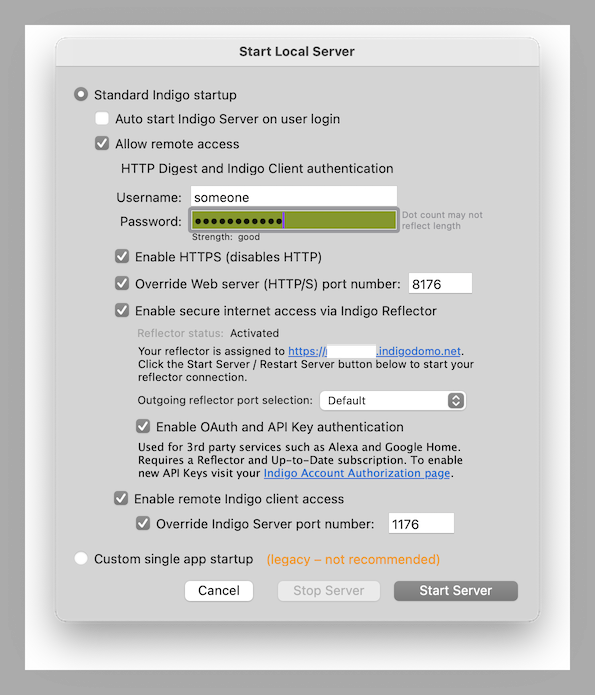

  1. Double click the Indigo 2025.1 application (/Applications/Indigo 2025.1.app).
  2. If this is the first time to run Indigo 2025.1 on this Mac, then press the Start Local Server… button in the connection status window.
  3. If you want to reconfigure the Indigo Server on a Mac already running Indigo, then select the Indigo 2025.1→Start Local Server… menu item.
Start Server Dialog Image
  • Outgoing reflector port selection: Some ISPs, especially satellite providers, may block incoming and outgoing connections – particularly if they sit idle for a time (which, in our opinion is ridiculous) – this setting provides a few options to hopefully work around these limitations. The setting you choose does not have any impact on performance. Further, the reflector port selection (or, in fact, the reflector itself) should have no impact on local web traffic performance (since the reflector isn't involved when a local network connection is made). If you're experiencing slowness with a local connection, check your router to ensure it isn't blocking or otherwise interfering with Bonjour traffic.
