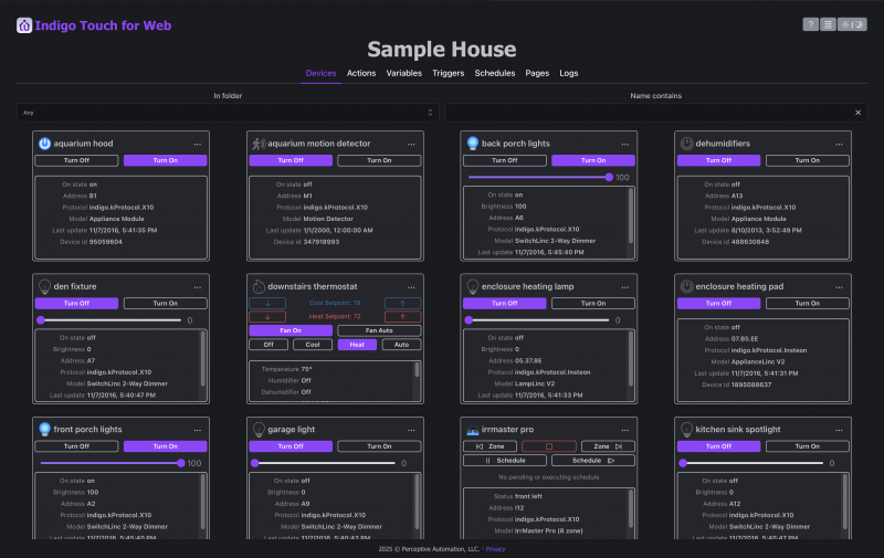

ITW currently supports two themes – light mode and dark mode. You can toggle between the two using the button at the top right of the screen. Your choice is saved locally via your browser's local storage, so the next time you visit, ITW will display using your theme preference. If you clear your browser's cache (including local storage), your preference choice will be erased. This setting is also browser specific so if you rotate among different browsers or have multiple users, each can have its own unique preference saved.
Light Mode Dark Mode
Indigo Touch Web Image Light Indigo Touch Web Image Dark

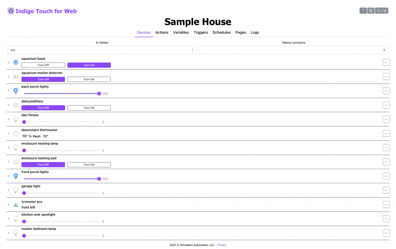

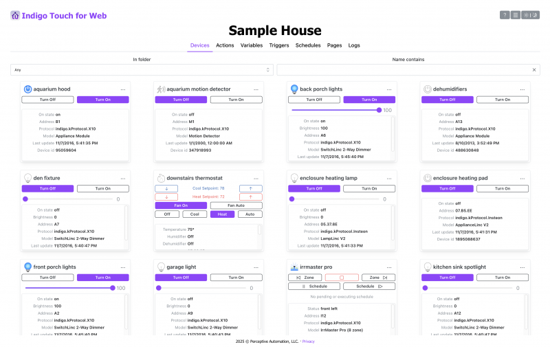

Indigo Touch Web supports two views–Tile view and List view. You can toggle between the two views using the view button located in the upper right corner.
Tile View List View
Indigo Touch Web Tile View Indigo Touch Web List View
Items in List view are collapsed by default. Clicking on the “>” next to an item will expand it to display things like additional controls and details. Click on the element's “>” again to collapse it.
List view is available for all ITW tabs (except log entries).
