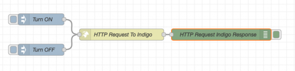

Node Red Example
The following example shows how to configure a Node Red flow that uses the Indigo Web Server (IWS) API to operate a lamp device. The example is only meant to show how to use a self-signed certificate and public key to enable the flow to connect to the IWS using https instead of http when using the IWS on a local network via 10.0.1.123, 127.0.0.1, or localhost (using the API via the Indigo Reflector Service uses a different CA-approved security certificate and the flow is configured the same as it would be using any API via https).

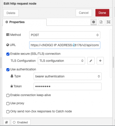

Using the flow via https requires a few settings. Enter the preferred URL to point at the local IWS address 10.0.1.123, 127.0.0.1, or localhost with the URL:
https://<INDIGO IP ADDRESS>:8176/v2/api/command/
for example,
https://10.0.1.123:8176/v2/api/command/
Node Red 6 HTTP Request Node Image

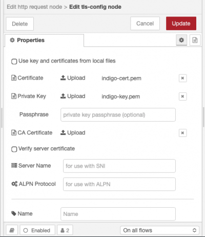

select TLS, and use bearer authentication along with a valid token key (from your Indigo Account Authorizations).
Then, use key and certificates from local files and point them to the certificate and public key files located in
/Library/Application Support/Perceptive Automation/Indigo 2025.1/Web Assets/cert/
Node Red 7 HTTP Request Node Image

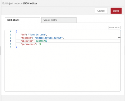

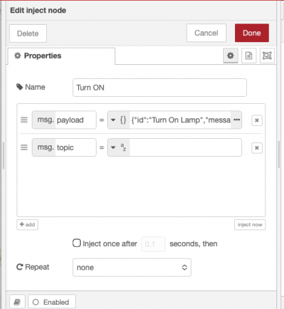

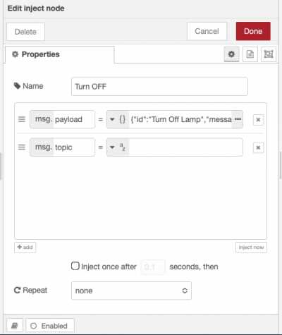

Several other screenshots complete the example:
Node Red Inject Node Turn On Image
Node Red Inject Node Turn On JSON Image

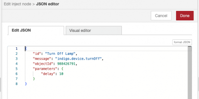

Node Red Inject Node Turn Off Image
Node Red Inject Node Turn Off JSON Image

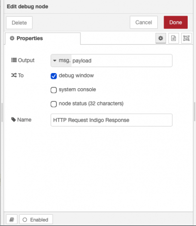

Node Red HTTP Debug Node Image
