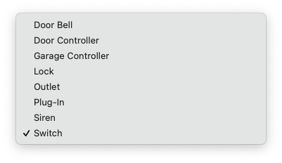

On/Off Devices
  • Alexa, turn on office lamp
  • Alexa, turn off bedroom fan
  • Alexa, open garage door
Alexa Relay Subtypes Image
The options are:
    • Alexa, open the front door
    • Alexa, open the garage door
    • Alexa, lock the back door
    • Alexa turn off desk lamp

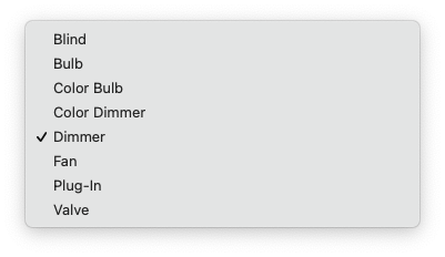

Dimmer Devices
warm, warm white 2200
incandescent, soft white 2700
white 4000
daylight, daylight white 5500
cool, cool white 7000
Alexa Dimmer Subtypes Image

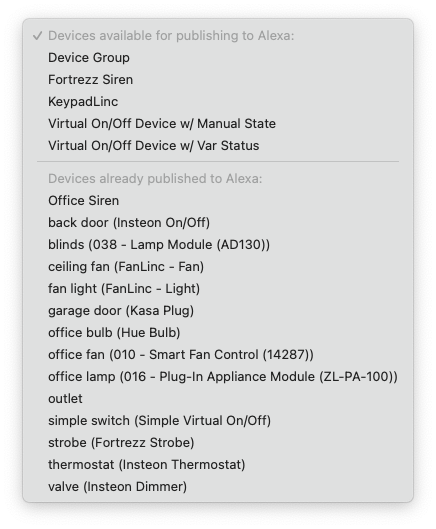

Plugin Startup
 Started plugin "Alexa 2024.1.0"
 Alexa                           Finding devices to publish to Alexa...
 Alexa                           ... '010 - Smart Fan Control (14287)' published as 'office fan'
 Alexa                           ... '016 - Plug-In Appliance Module (ZL-PA-100)' published as 'office lamp'
 Alexa                           ... '038 - Lamp Module (AD130)' published as 'blinds'
 Alexa                           ... 'automatic door' published
 Alexa                           ... 'FanLinc - Fan' published as 'ceiling fan'
 Alexa                           ... 'FanLinc - Light' published as 'fan light'
 Alexa                           ... 'Fortrezz Strobe' published as 'strobe'
 Alexa                           ... 'Hue Bulb' published as 'office bulb'
 Alexa                           ... 'Insteon Dimmer' published as 'valve'
 Alexa                           ... 'Insteon On/Off' published as 'back door'
 Alexa                           ... 'Insteon Thermostat' published as 'thermostat'
 Alexa                           ... 'Kasa Plug' published as 'garage door'
 Alexa                           ... 'Office Siren' published
 Alexa                           ... 'outlet' published
 Alexa                           ... 'Simple Virtual On/Off' published as 'simple switch'
 Alexa                           A total of 15 devices are currently published to Alexa
 Alexa Warning                   If you can't control a device, rerun discover from your Alexa device.
Showing Publications
 Alexa                           Currently published devices (Alexa name first if different than Indigo name):
 Alexa                             'Office Siren' ('Office Siren') - Type: RelayDevice - Subtype: Siren
 Alexa                             'automatic door' ('automatic door') - Type: RelayDevice - Subtype: Door Controller
 Alexa                             'back door' ('Insteon On/Off') - Type: RelayDevice - Subtype: Lock
 Alexa                             'blinds' ('038 - Lamp Module (AD130)') - Type: DimmerDevice - Subtype: Blind
 Alexa                             'ceiling fan' ('FanLinc - Fan') - Type: SpeedControlDevice - Subtype: None
 Alexa                             'fan light' ('FanLinc - Light') - Type: DimmerDevice - Subtype: Dimmer
 Alexa                             'garage door' ('Kasa Plug') - Type: RelayDevice - Subtype: Garage Controller
 Alexa                             'office bulb' ('Hue Bulb') - Type: DimmerDevice - Subtype: Color Bulb
 Alexa                             'office fan' ('010 - Smart Fan Control (14287)') - Type: DimmerDevice - Subtype: Fan
 Alexa                             'office lamp' ('016 - Plug-In Appliance Module (ZL-PA-100)') - Type: RelayDevice - Subtype: Plug-In
 Alexa                             'outlet' ('outlet') - Type: RelayDevice - Subtype: Outlet
 Alexa                             'simple switch' ('Simple Virtual On/Off') - Type: RelayDevice - Subtype: Switch
 Alexa                             'strobe' ('Fortrezz Strobe') - Type: RelayDevice - Subtype: Plug-In
 Alexa                             'thermostat' ('Insteon Thermostat') - Type: ThermostatDevice - Subtype: None
 Alexa                             'valve' ('Insteon Dimmer') - Type: DimmerDevice - Subtype: Valve

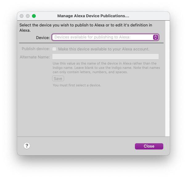

  4. Once you have all your devices published, you can confirm that they are all published by selecting the Plugins→Alexa→Show Device Publications menu item and it will print the list of publications in the Event Log window.
  5. In the Alexa app, website, or using an Alexa enabled device, click/touch the Discover button or say “discover devices”.
   Alexa                           Alexa discovery request received, assembling reply...
Partial Switch
  4. In the Alexa app, website, or using an Alexa enabled device, click/touch the Discover button or say “discover devices”.
