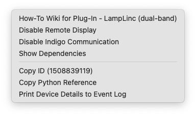

Device Contextual Menu Image
This menu will:
  6. Copy a Python script string that will return an instance of the selected device. It will look like this: indigo.devices[91776575] # “Living Room Switch”
  7. Print all the information about a device to the Event Log window. It will look something like this:

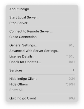

Indigo Menu Image
  • About Indigo 2024.1 - this will show the About window which will show what client and server versions you're running and will show your registration code
  • Start Local Server… - this will open the Start Server dialog
  • Connect to Remote Server… - this option will allow you to connect to a different Indigo server or a server running on another Mac
  • General Settings… - this opens the preferences dialog

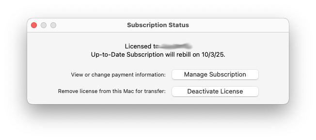

  • License Details… - this opens the Subscription Status window that will show you the status of your License and it's associated Up-to-Date Subscription:
Subscription Status Image

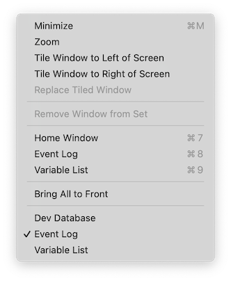

Window Menu Image
The bottom of the menu will display the list of open windows, where the name of the active database will replace “Home Window”.

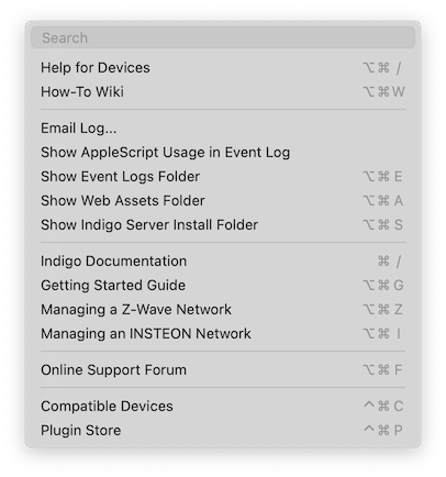

Help Menu Image
  • How-To Wiki - this will change slightly based on what's selected - it will open to the How-To wiki for the selected item (if a device is selected it will go to the wiki for that device, otherwise it will just go to the landing page)
  • Email Log… - this option emails some of your event log data to the specified email address. Particularly useful for technical support
  • Show AppleScript Usage in Event Log - this option prints a list of AppleScripts that are embedded in actions that you have specified. This will help to identify and replace those scripts.
  • Show Event Logs Folder - this option will switch to the Finder and open the folder that contains the Event Log log files.
  • Show Web Assets Folder - this option switches to the Finder and open the folder that contains custom images, text files, etc., that you might want to give Indigo (and others) access to through the Indigo Web Server.
  • Show Indigo Server Install Folder - this option opens a Finder window that displays the folder of the currently running Indigo installation. This will only run from the server machine (you'll receive a warning otherwise).
  • Indigo Documentation - this option will open your browser to the landing page for all Indigo 2024.1 documentation
  • Getting Started Guide - this option opens your browser to the Getting Started Guide, the place where everyone new to Indigo should start
  • Managing a Z-Wave Network - this option opens a browser window to the Managing Your Z-Wave Network document in our Documentation wiki
  • Managing an INSTEON Network - this option opens a browser window to the Managing Your INSTEON Network document in our Documentation wiki
  • Online Support Forum - this option opens your browser to our support forum - it's very active and is the primary place where you should seek help - we answer questions there very quickly and in fact we have many helpful users that can help as well
  • Compatible Devices - this option opens a browser window on our new Compatible Devices list that shows which devices and interfaces have been tested with Indigo and includes devices supported by 3rd party plugins
  • Plugin Store - this option opens your browser to our Plugin Store where you can browse and download hundreds of 3rd party plugins that add functionality to Indigo
