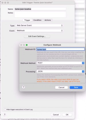

On the Indigo side, we're going to create a variable called home and then add a webhook trigger that will catch the webhook from Locative and change the variable value to the value received in the trigger field. Here are the steps:
  1. Create a variable and name it “home” (or whatever you want)
  2. Configure a new Webhook Trigger action (select Web Server Event from Type and Webhook from Event).
The Webhook ID field specifies the name of the webhook that you'll use on your URL. The Method is POST and the processing is JSON. Next, switch to the Actions tab and select Variable Actions→Insert Event Data into Variable from the Type popup, which will bring up the config dialog for that action:
Select the Variable you created in step 1 above, then enter data.trigger in the Path specifier field. A brief reminder: this is what the event_data contains from a webhook trigger event:

Create a new Geofence that represents your home (or whatever). Here's how the webhooks are configured in Locative:
You set the URL in both arrival and departure to this:
https://REFLECTORNAMEHERE.indigodomo.net/webhook/home-json?api-key=APIKEYHERE
Change to your reflector name and add an API key at the end. Note the webhook ID that you set in the trigger definition is used as the last part of the path specifier (home-json in this case). Then select POST for both, then JSON (or whatever you named your definition).

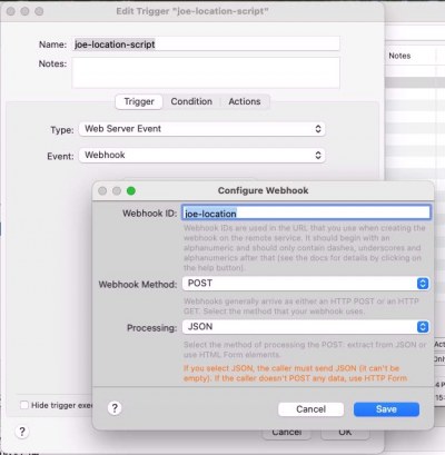

First, let's create the Indigo webhook. Here's the trigger definition:
It's a straight-forward JSON POST webhook named joe-location. The action is where the real work is. Select the Server Actions→Script and File Actions→Execute Script, with the following script:
