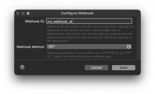

  1. Create a variable and name it “home” (or whatever you want)
  2. Configure a new Webhook Trigger action (select Web Server Event from Type and Webhook from Event).
The Webhook ID field specifies the name of the webhook that you'll use on your URL. The Method is POST and the processing is JSON. Next, switch to the Actions tab and select Variable Actions→Insert Event Data into Variable from the Type popup, which will bring up the config dialog for that action:
Select the Variable you created in step 1 above, then enter data.trigger in the Path specifier field. A brief reminder: this is what the event_data contains from a webhook trigger event:

  1. In Indigo, create a new Trigger.
  2. Under Type, select Web Server Event.
  3. Under Event, select Webhook.
  4. Under the Configure Webhook dialog, copy the Webhook ID and paste it somewhere safe. If you want, you can change the ID to something else – it must be unique.
  5. Under Webhook Method, ensure it's set to POST.
  6. Under Processing, ensure it's set to JSON.
  7. Set up the Action for your Indigo Trigger (send an email, write to the event log, etc.)
  8. Save your Trigger.
