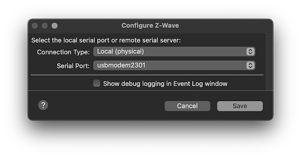

Connecting Z-Wave Interfaces
The GoControl QuickStick Combo is an interface that includes both Z-Wave and Zigbee (though Zigbee isn't supported natively in Indigo). It also requires that you install the Silicon Labs VCP Driver Kit for Mac OS X, specifically v5 or later. It will then present 2 new serial ports: GoControl_zwave (which is the one you select) and GoControl_zigbee (for the Zigbee interface).
- Choose the
Interfaces→Z-Wave→Enablemenu item. This should cause theConfigure Z-Wavedialog to open automatically (but only the first time you enable Z-Wave - you can select theInterfaces→Z-Wave→Configure…menu item to get back to the configuration dialog later): - The default
Connection TypeofLocal (physical)is correct (assuming you've plugged your Z-Stick directly into your Mac). - On the
Serial Portpopup, you should select the serial port titledSLAB_USBtoUART(for Z-Stick Series 2) or one that starts withusbmodem(for Z-Stick Gen5), depending on which Z-Stick version you have. If you have two serial ports that start withSLAB_USBtoUARTthat means that you have multiple devices that use the Silicon Labs VCP driver - you'll just need to try each one to determine which is the correct port if you don't know beforehand. Unfortunately, that driver doesn't handle multiple devices using the Silicon Labs chip very well, and that number may change when you reboot. - Unless instructed by Perceptive Automation support, you should leave the
Show debug logging of interface communicationcheckbox unchecked. - Save the
Configure Z-Wavedialog.

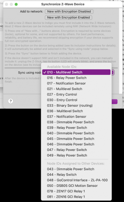

Adding a Z-Wave Device
- Select
DEVICESin the Main Window outline view or select one of the sub-folders. - Click the
New…button. You'll see theCreate New Devicedialog. - Select
Z-Wavefrom the Type popup menu. - Click the
Define and Sync…button. - You'll see the
Synchronize Z-Wave Devicedialog. - Follow the directions on the dialog to complete setting up the device.

Replacing a Z-Wave Device
- Select
DEVICESin the Main Window outline view or select one of the sub-folders. - Find the device in the device table and double click it (or select it and click the
Edit…button). - Click the
Define and Sync…button. - Follow the instructions on the dialog to use your controller to include the device into your network if you haven't already.
- Select the new device in the
Sync using nodepopup. - Click on the “Sync” button.
- When the
Synchronize Z-Wave Devicedialog disappears, just close theEdit Devicedialog.
Note that not all devices can be replaced. Specifically, if a device has multiple personalities (like, for instance, a multi-sensor that has a motion sensor, temp sensor, humidity sensor, etc.) and any of those dependent devices are used in Triggers, Conditions, Actions, or Control Pages, then you'll get an error message in the Event Log window saying that you need to manually resolve those conflicts (or manually delete the device). Indigo helps with this process - see Deletion Dependencies for details.
IMPORTANT: When replacing or resyncing a device (particularly a battery-powered device), the device may enter sleep mode before we can finish all the sync activities needed to re-add the device. If this happens, you'll get an error before the sync is finished. In this case, you can often just repeatedly tap the include button/paddle, tamper button/mechanism, etc., to keep the device awake. Another option is to remove the batteries from the device and wait a few minutes. Then reinsert them (which will often put the device into an awake status for several minutes) then do the sync again.
