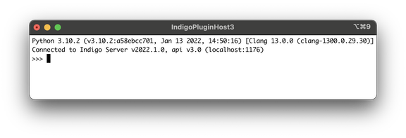

The Indigo Plugin Host (IPH) provides a python scripting and plugin environment, which makes controlling the Indigo Server easy via the high-level python language (the official python website has great python tutorials). Every plugin automatically runs inside its own Indigo Plugin Host process, but you can also start the IPH in an interactive mode to directly communicate with the Indigo Server. It is a great way to experiment with Indigo's python environment, which is available to both python scripts run by Indigo and the plugin architecture. Want the ability to just put some Python scripts onto a menu somewhere for easy access? There's a simple way to do it.

/usr/local/indigo/indigo-host
Plugin Host Prompt Image
