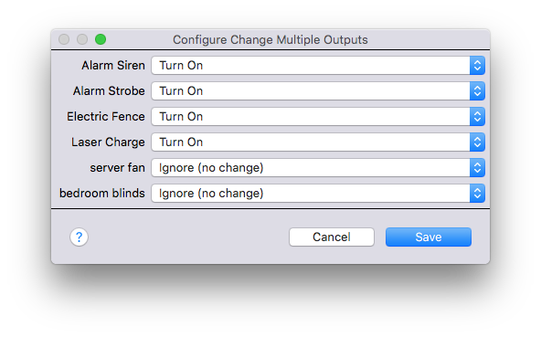

Some actions have additional options available via the Edit… button. For example, the Change Multiple Outputs action allows you to control (turn on, turn off, or toggle) all the outputs with a single, and very fast, action:
Easydaq Action Change Multi Window Image
