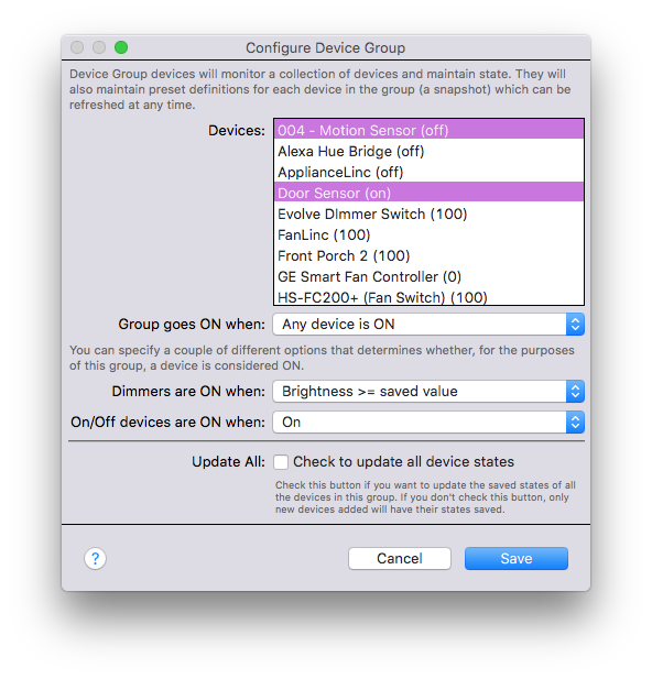

With the addition of Z-Wave (and various plugins that define dimmer and relay devices) it has become apparent that we need to provide some way to create technology-agnostic groups of devices. You can, of course, control groups of devices through Action Groups, and for most cases that's good enough.
