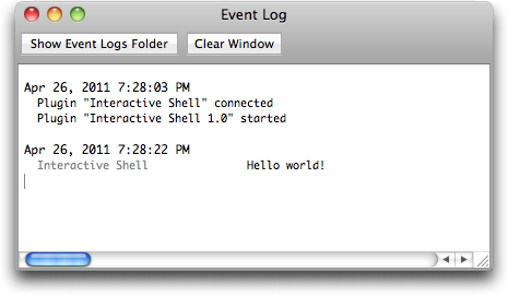

As shown, the IPH will automatically connect to the IndigoServer running on the same Mac and will show the server's version information. Additionally, you'll notice that Indigo Server logs the connection of the interactive shell plugin.
Hello World Code Image
