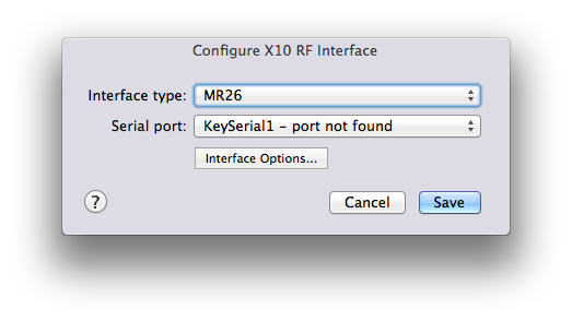

X10
X10 is a legacy technology that works primarily over the power line though some devices are wireless (using the X10 RF protocol). We don't recommend anyone start a new home automation system using X10 because of it's poor reliability - however, if you have existing X10 devices you can definitely use them with Indigo if you have a compatible X10 interface. These are the X10 interfaces that Indigo supports:
- ActiveHome Pro (CM15A) - includes X10 RF (wireless) receiving
- ActiveHome (CM11) - X10 power line only
- W800RF (USB or Serial) - X10 RF (wireless) receiving only
- X10 PC Receiver (MR26A) - X10 RF (wireless) receiving only
- PowerLinc Modem 2412U/2412S/2413U/2413S/ - as noted above, these are primarily INSTEON interfaces but also work with X10 (power line only)

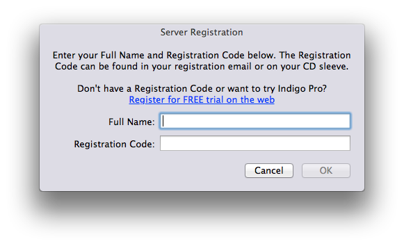

Starting the Server
If this is the first time you've started the server, you'll be prompted first to click through our Enduser License Agreement (EULA), then you'll see the server registration dialog:
Enter you name and registration code exactly as they appear in your registration email (copy/paste works best) and click OK. The server will continue to start up.
If you purchased a retail disk, you should enter your full first and last name along with the registration code exactly as it appears on the label on the disk sleeve. When you click OK you'll be prompted to register your copy on our website.
While this isn't required, it's highly recommended. If you don't, we won't be able to locate your registration code in the future should you need it again - and you will to get discounted upgrades to major new releases and access to dot releases.

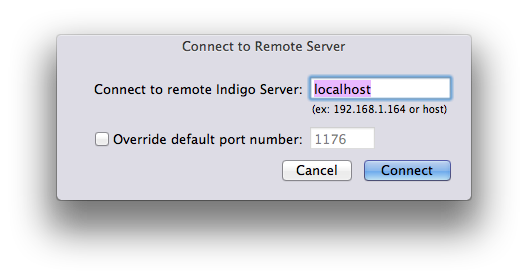

- Double click the
Indigo 6application (inside/Applications/Indigo 6) on the remote Mac. - If this is the first time to run
Indigo 6on this remote Mac, then press the Connect to Remote Server… button in the connection status window. - If you are wanting to connect to a different Indigo Server, then select the
Indigo 6→Connect to Remote Server…menu item. - Enter the
Connectbutton.
NOTE: the Indigo Mac Client doesn't use the Reflector service. Connecting an Indigo Mac Client to a server over the internet is a complex topic that is well beyond this document – we suggest you search our online forums for others that have configured this type of access.

Connecting X10 RF Interfaces
The process for connecting X10 RF Interfaces is basically the same as for power line interfaces - you just need to select the correct serial port. The W800USB will require installing the FTDI drivers mentioned above. You only need to use this interface if you're using a separate X10 RF interface like the W800 or MR26. If you are using a CM15 then enable it in the Connecting INSTEON and X10 Power Line Interfaces section above.
