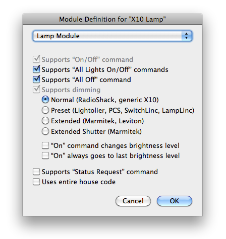

However, you may have a device module not currently listed in the Type popup menu. To use devices that are not defined in the device Type popup, you can click the Definition… button you will be shown the Module Definition dialog:
X10 Definitions Dialog Image
