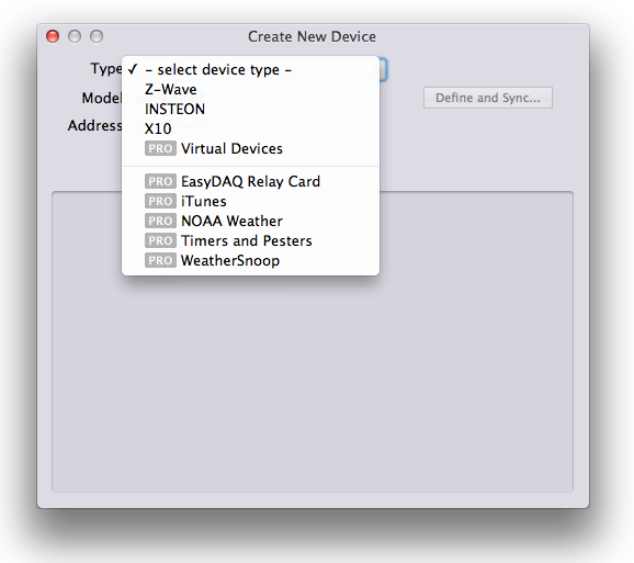

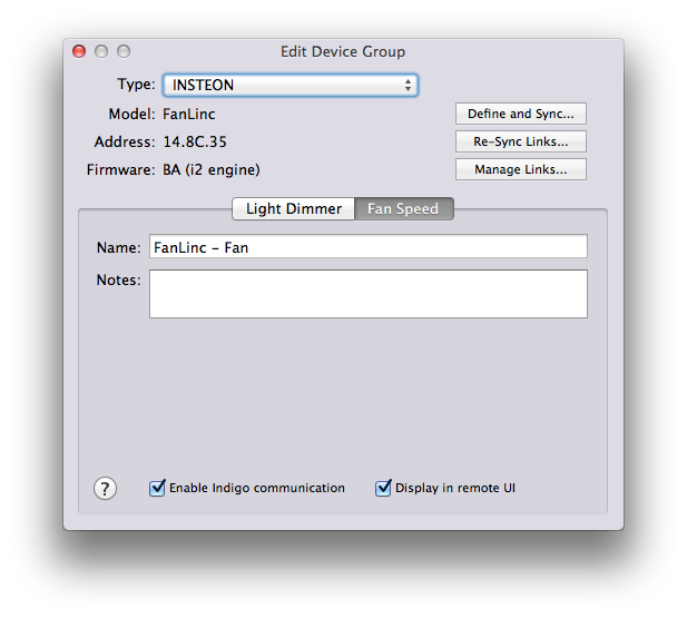

Here is the device dialog:
Device Options
Enable Indigo communicationcheckbox - this is useful if you have a device that you're temporarily taking out of service or moving. If you uncheck this checkbox, Indigo will not attempt to communicate with it in any way - so you won't receive errors in the Event Log when any action is taken for this device.Display in remote UIcheckbox which, as it says, lets you see this device in remote client applications.

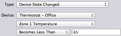

Device State Changed

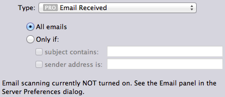

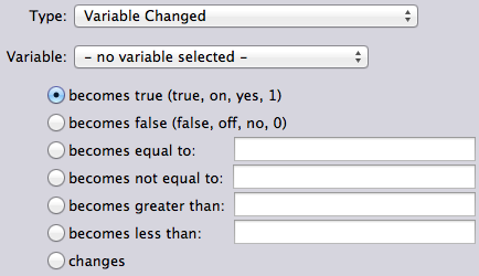

Email Received

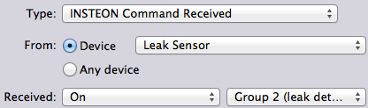

INSTEON Command Received

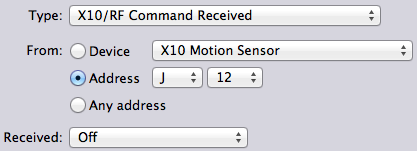

X10/RF Command Received

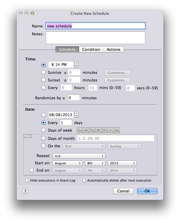

Schedules
Time
- Absolute time - in the case of the figure above, the schedule will execute at 2:18pm local time

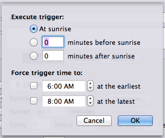

- Time relative to Sunrise - so some number of minutes before or after sunrise depending on the value in the text box (use negative numbers for before sunrise). For more specific options click the
Customizebutton (see image below):At sunriseis the default (0 is inserted into the text box on the main dialog)- X
minutes before sunrise(-X is inserted into the text box on the main dialog) - X
minutes after sunrise(X is inserted into the text box on the main dialog) Force trigger time to Y at the earliestwill cause the trigger to execute at the specified time if the minutes before sunrise specification is earlier than YForce trigger time to Y at the latestwill cause the trigger to execute at the specified time if the minutes after sunrise specification is later than Y
- Time relative to Sunset - works the same as the above option but with respect to Sunset rather than Sunrise
- Every X hours Y minutes Z seconds - this is the typical repeating setting.
Date
- Absolute Date - execute this schedule on a specific date
- Repeating every number of days - the default option repeats every day though you can change that to every X number of days
- Absolute days of the week - execute only on certain days of the week (not that darkened days are selected, lightened aren't)
- Absolute days of the month - specify each day of the month on which to execute the schedule separated by a comma
- Fixed days of the month - specify advanced day settings such as third Thursday of the month
- Repeat allows you to specify repetition. This one changes based on what you have selected above:
- For absolute date you can specify yearly repetitions (e.g. every year, every 3 years, etc.)
- Disabled for repeating every number of days since that already specifies repetition
- For Absolute days of the week you can specify weekly repetitions (e.g. every week, every 6 weeks, etc.)
- For Absolute days of the month and Fixed days of the month you can specify monthly repetitions (e.g. every month, every 4 weeks, etc.)
- Start on allows you to specify some date in the future to begin on (disabled for the first option since that specifies an absolute date)
- Optional End on date so you can specify an absolute date on which to stop any repetition.

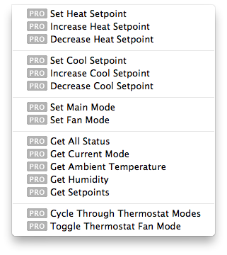

Thermostat Controls
Set Heat Setpoint- set the heat setpoint to an absolute temperatureIncrease Heat Setpoint- increase the heat setpoint by some number of degreesDecrease Heat Setpoint- decrease the heat setpoint by some number of degreesSet Cool Setpoint- set the cool setpoint to an absolute temperatureIncrease Cool Setpoint- increase the cool setpoint by some number of degreesDecrease Cool Setpoint- decrease the cool setpoint by some number of degreesSet Mode- set the mode of the thermostat to one of the following:All Off- set the HVAC unit so that both heat and cool setpoints are ignored - the unit will not come on at allHeat On- activate the HVAC unit so that only the heat setpoint is usedCool On- activate the HVAC unit so that only the cool setpoint is usedHeat/Cool On- activate the HVAC unit so that both heat and cool setpoints are usedRun Heat Program- tell the thermostat to run the heat program that is programmed directly into the thermostat (see the thermostat documentation for details)Run Cool Program- tell the thermostat to run the cool program that is programmed directly into the thermostat (see the thermostat documentation for details)Run Heat/Cool Program- tell the thermostat to run the heat/cool program that is programmed directly into the thermostat (see the thermostat documentation for details)Fan Auto On- set the fan so that it only runs as neededFan Always On- turn the fan on so it'll continuously run
Get All Status- get all information from the thermostatGet Current Mode- get the current modeGet Ambient Temperature- update the temperatureGet Ambient Humidity- get the humidityGet Setpoints- get the setpointsCycle Through Thermostat Modes- this will allow you to easily cycle through thermostat modes in this order: Off, Cool, Heat, Auto. Especially useful in conjunction with the “Thermostat Mode+.png” image on a control page - just add this as a server action and you have a simple control for adjusting the thermostat mode - each time you tap/click the image, the thermostat selected will cycle to the next mode just like pressing the Mode button on the thermostat itself (if it has one).Toggle Thermostat Fan Mode- like the action above, this method will toggle between the two fan modes: Fan On (always on) and Fan Auto (automatic). Again, useful with the “Thermostat Fan Mode+.png” image file.
v1 INSTEON thermostat adaptors didn't broadcast out changes to update it's internal state representations for the thermostats - which is why there are so many options to get status. Indigo 7 catches the v2 thermostat update broadcasts so the need to manually get updates should be reduced.

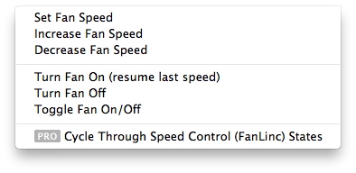

Fan Speed Controls
Set Fan Speed- set the speed of the device to a specific levelIncrease Fan Speed- increase the fan speed by some # of units - for instance, on a FanLinc that's currently onLow, increasing the fan speed by 1 will set it toMediumDecrease Fan Speed- decrease the fan speed similarly to the above Increase Fan SpeedTurn Fan On (resume last speed)- this will turn the fan on to it's last speed settingTurn Fan Off- turn the fan off completelyToggle Fan On/Off- toggle between on and offCycle Through Speed Control (FanLinc) States- use this action to cycle through the fan speeds in this order: High, Medium, Low, Off. It's basically an electronic version of pulling the fan's chain.

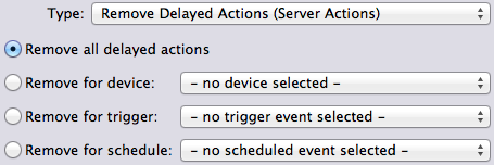

Remove Delayed Actions
Remove all delayed actions- this will remove all delayed actions regardless of delay typeRemove for device- remove any delays for the selected deviceRemove for trigger- remove any delays from the selected triggerRemove for schedule- remove any delays from the selected schedule

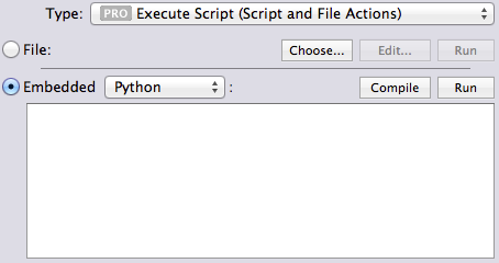

Execute Script
The Execute Script action allows you to execute either a Python or AppleScript as an embedded script or stored in a script file. In general, you should use embedded scripts for scripts that are short and very quick to execute.
Embedded Python scripts will be limited to 10 seconds of execution time - if they run longer than that they will be killed. If you have a Python script that is a long running script you should save it in a separate file and execute it from the file by selecting the File radio button then selecting the file. Python scripts executed from files are executed in their own process and are therefore much less likely to adversely effect the server process if they don't work as expected.
Embedded AppleScripts must run on the server's main execution thread so if it delays, can hang on external events like network access, or otherwise does a lot of processing, then everything else in the server will be put on hold until the script is finished. Therefore, you definitely should keep embedded AppleScripts very simple. As with Python scripts, long running AppleScripts should be stored in a separate AppleScript file (created with Script Editor) and executed that way - external AppleScript files execute in their own process and are therefore much less likely to adversely effect the server process if they don't work as expected.

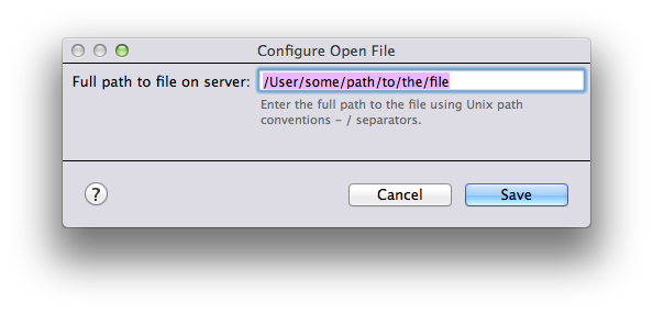

Open File

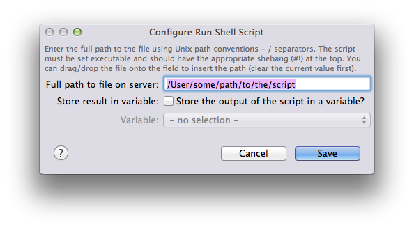

Run Shell Script
This will run the specified script file optionally with the output being inserted into the specified variable. The script must be marked executable and a valid shebang (#!/path/to/shell) must be specified at the top of the script. Note - this won't work for AppleScripts - you should use the built-in Execute Script action and select the script file that way. Also, if you're running a Python script you'll probably just want to use the Execute Script action since script files run from this plugin won't have access to the IOM (import indigo, which is Python-only).

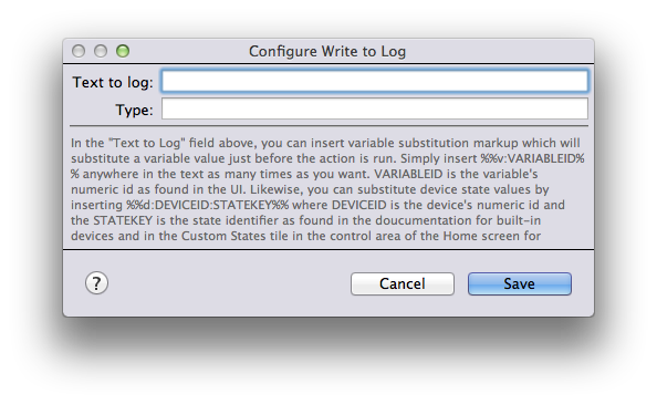

Write to Log

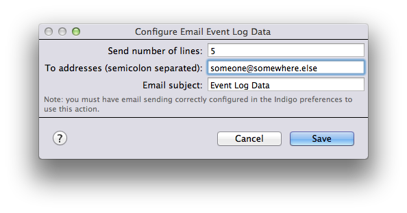

Email Event Log Data

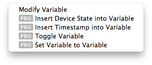

Variable Actions
There are three actions that are specific to variables.

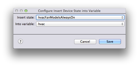

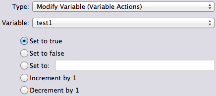

Modify Variable

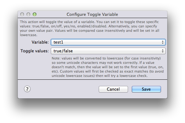

Toggle Variable

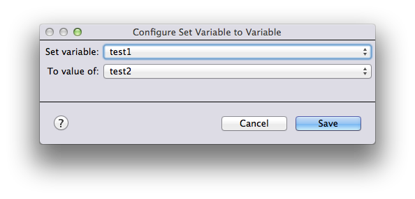

Set Variable to Variable

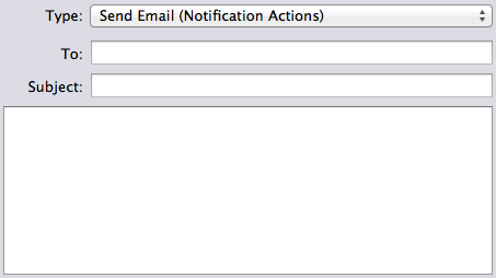

Send Email

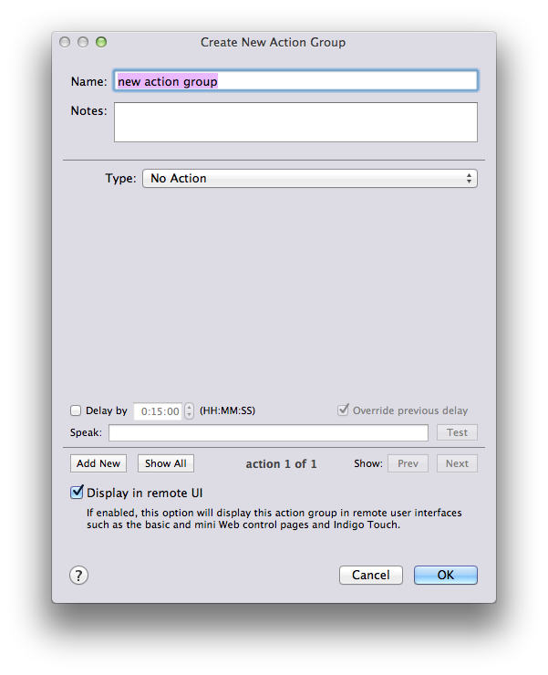

Action Groups
To create a new action group:
- Select
Action Group Listfrom theViewmenu. - Press the

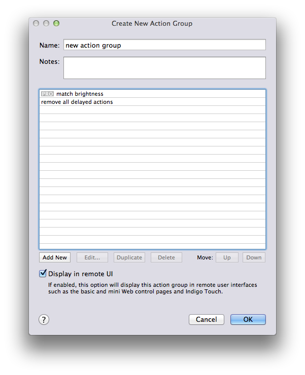

New…button at the top of the main window. Namethe group, for example “going to bed.”- Optionally give the group some
Notes. - Select the action
Type:and select the various options. (See the actions section above for details on all of the action's settings, and information on managing multiple actions to the Action Group)

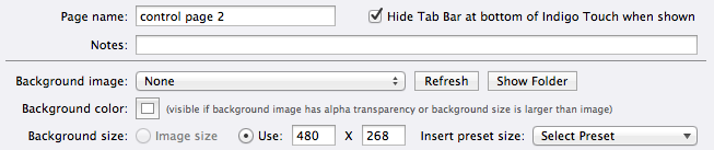

Control Page Editor
- iPhone/iPod touch
- Viewable Portrait size: 320×416
- Viewable Landscape size: 480×268
- iPad
- Viewable Portrait size: 768×960
- Viewable Landscape size: 1024×704

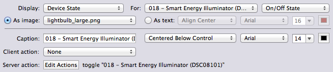

Device State

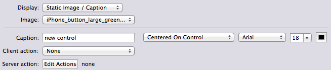

Static Image/Caption

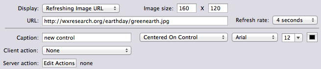

Refreshing Image URL

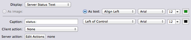

Server Status Text
Server Status Icon

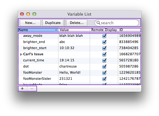

Variables
Variables are used to hold information that can help your home automation logic. For instance, Indigo ships with an AppleScript which stores weather information in variables. You can use that information to display on control pages, as part of your conditional logic (see Conditions below), or as a trigger for some other action.

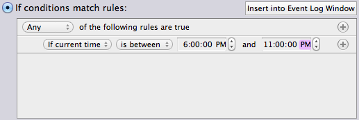

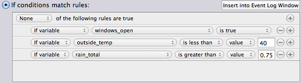

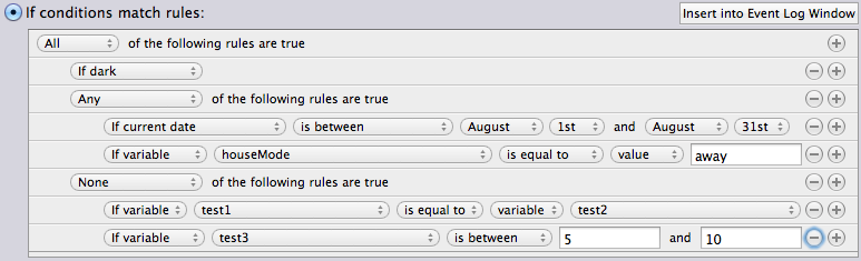

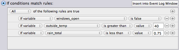

Conditions
- if you've left your windows open
- if it's too cold outside
- if it has rained more than 3/4 of an inch in the last 24 hours.
"If dark"
