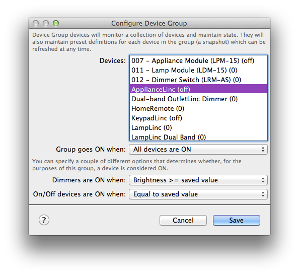

To create a device group, you just create a new device, select Device Collection from the Type menu, select Device Group from the model menu, and you'll see the configuration dialog:
Select the devices you want to be in the group (only dimmer devices, relay (on/off) devices, and sensor devices that support an on/off state are available). To select multiple, hold down the command key and click the device in the list. Notice that the devices all have something in parentheses after the name - that's the current value of the device that will be saved. If it's a dimmer device, it shows the brightness and if it's a relay (On/Off) device, it shows whether it's on or off. When you save, that's the value that will be saved.
To use a device group, just use the standard Control Light/Appliance action to turn it ON/OFF, and create triggers on the group's ON and OFF state via the Device State Changed trigger type. You can also update the states of the devices in the group at any time by using the Update Device Group States action or menu item. That's it!

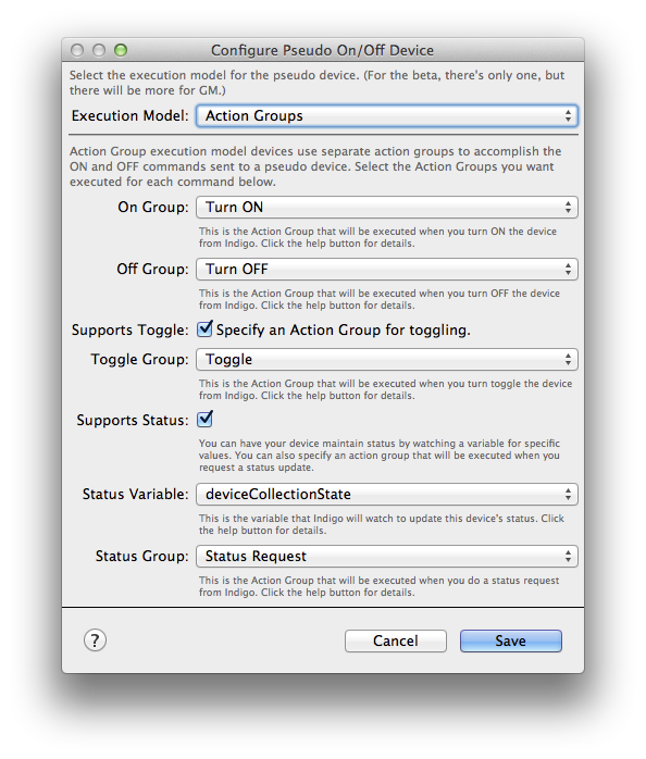

For the Indigo 6 GM release, we've only implemented Action Groups, but in future releases we may add other execution models.
Action Groups
Finally, your virtual device can maintain a state if you like. But, Action Groups can't directly manipulate state you say, right? Well, that's true. However, Action Groups can modify a variable. So, we've allowed you to select a variable and we'll monitor that variable for any change. If the value of the variable becomes “on”, we set the state of the virtual device to on. If the variable becomes “off”, then we set the state to off.
