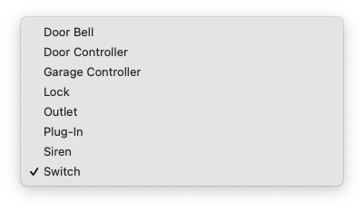

Alexa Type Popup Image
Device Types Supported
On/Off Devices
Alexa Relay Subtypes Image
The options are:
