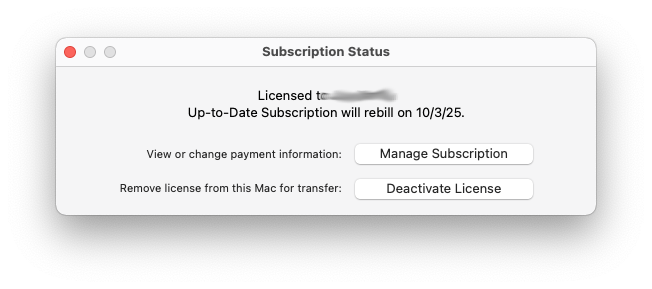

About Indigo 2022.2 - this will show the About window which will show what client and server versions you're running and will show your registration codeStart Local Server… - this will open the Start Server dialogStop Server - this will stop the Indigo ServerConnect to Remote Server… - this option will allow you to connect to a different Indigo server or a server running on another MacClose Connection - this will close the connection to the serverPreferences… - this opens the preferences dialogLicense Details… - this opens the Subscription Status window that will show you the status of your License and it's associated Up-to-Date Subscription:

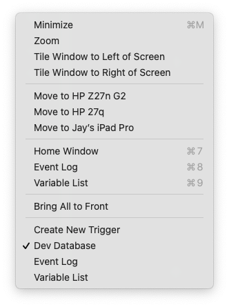

Home Window - this will show/bring to front the Home WindowEvent Log - this will show/bring to front the Event Log WindowVariable List - this will show/bring to the front the Variable List Window

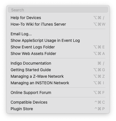

Help for XXXX - this will change slightly based on what window is selected and what's selected in that window - but it will open the default browser to the page in the help documentation for that particular itemHow-To Wiki - this will also change slightly based on what's selected - it will open to the How-To wiki for the selected item (if a device is selected it will go to the wiki for that device, otherwise it will just go to the landing page)Email Log… - this option will email some of your event log data to the specified email address. Particularly useful for technical supportShow AppleScript Usage in Event Log - this option will print a list of AppleScripts that are embedded in actions that you have specified. This will help to identify and replace those scripts.Show Event Logs Folder - this option will switch to the Finder and open the folder that contains the Event Log log files.Show Web Assets Folder - this option will switch to the Finder and open the folder that contains custom images, text files, etc., that you might want to give Indigo (and others) access to through the Indigo Web Server.Indigo Documentation - this will open your browser to the landing page for all Indigo 2022.2 documentationGetting Started Guide - this will open your browser to the Getting Started Guide, the place where everyone new to Indigo should startManaging a Z-Wave Network - opens a browser window to the Managing Your Z-Wave Network document in our Documentation wikiManaging an INSTEON Network - opens a browser window to the Managing Your INSTEON Network document in our Documentation wikiOnline Support Forum - this will open your browser to our support forum - it's very active and is the primary place where you should seek help - we answer questions there very quickly and in fact we have many helpful users that can help as wellCompatible Devices - opens a browser window on our new Compatible Devices list that shows which devices and interfaces have been tested with Indigo and includes devices supported by 3rd party pluginsPlugin Store - this will open your browser to our Plugin Store where you can browse and download hundreds of 3rd party plugins that add functionality to IndigoZ-Wave® is a registered trademark of Sigma Designs, Inc. Indigo's support of Z-Wave hardware is neither endorsed nor certified by Sigma Designs.
