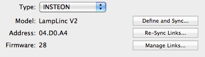

The Re-Sync Links… dialog will open the Synchronize INSTEON Device Links dialog:
The last button, Manage Links… is how Indigo allows you to remotely manage INSTEON links (without having to walk around pressing set buttons, etc.) and is discussed in great detail on the Indigo INSTEON Link Management page.

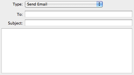

Delay by X minutes - this will delay the execution of the action by some number of minutes (you can add fractional minutes as well e.g. .5 is 30 seconds, etc.)Override previous delay - this will automatically delete any previous delays specified for the action aboveSpeak - if you enter text in the text box Indigo will use the voice synthesis to speak the text

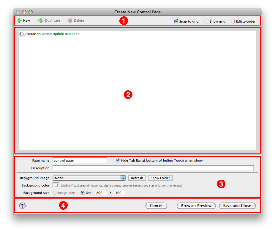

Control pages are custom graphical pages that you can use to control Indigo, either through the browser or Indigo Touch. You design the page - from the background image and/or color to the placement of text labels, control images, and what actions clicking/tapping on those images performs.
This is where you set global information about the page itself. The Page Name: and Description: fields are pretty self-explanatory. Check the Hide Tab Bar at bottom of Indigo Touch when shown to have the bottom navigation bar hidden when this page is viewed in Indigo Touch. You can use a Background image: by selecting it from the popup, such as a floorplan or other image. You can add your own image by creating a PNG file and adding it to the backgrounds folder (to open that folder in the Finder just click the Show Folder button - and if you add an image while Indigo is running, click the Refresh button to have it added to the popup).
