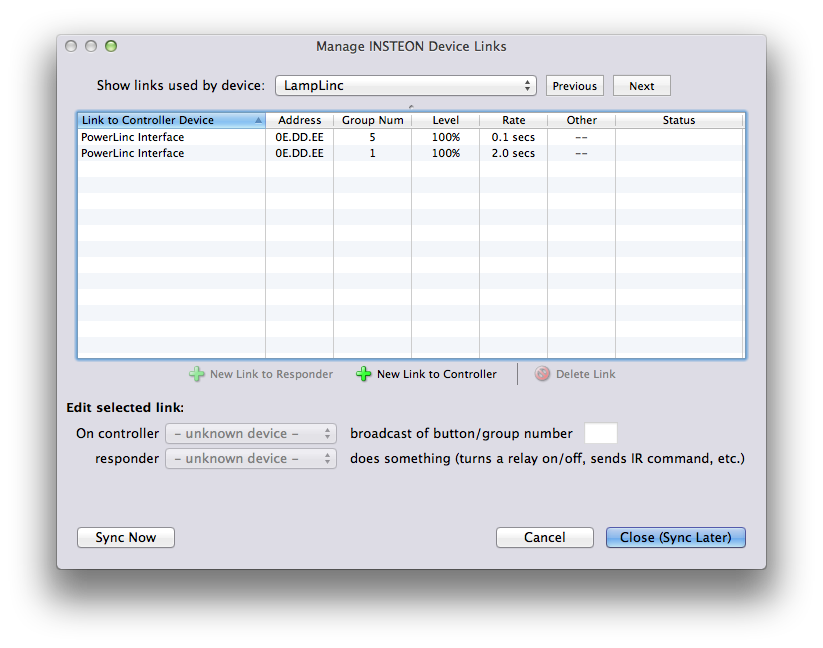

The primary place that you'll manage links between devices is in the Manage INSTEON Device Links dialog. Select the from Interfaces→INSTEON/X10 Power Line→Manage INSTEON Device Links menu item and the dialog will popup:
Device Links Dialog Image
For example, you can use Indigo to remotely program button #1 on a RemoteLinc to: set the thermostat to 68°, brighten the bedroom sconces to 75%, dim the bedroom overhead fixture down to 35%, turn off the hallway and bathroom lights.
Device Links Example Image
Indigo automatically creates the links to define the scene in most remote modules. This means you do not have to press-and-hold the set button or up paddle on most remote modules. Indigo will do it all remotely for you with a single press of the Sync Now button. See the Supports Remote Link Management column of the INSTEON module and Indigo 4 compatibility table for information on which modules Indigo can remotely manage.
You can also define Indigo initiated scenes to control multiple remote modules in unison. See the defining Indigo INSTEON scenes section for more information on this capability.
  1. Select the Interfaces→INSTEON/X10 Power Line→Manage INSTEON Device Links menu item.
Lastly, to have Indigo write all of your link changes to the remote modules, press the Sync Now button to have Indigo immediately write all changed links to the remote modules. Or, press the Close (Sync Later) button to close the link editor window and write the changes to the modules at a later time. When you are ready to write the changes to the remote modules, select Start Sync INSTEON Device Links… from the Interfaces→INSTEON/X10 Power Line menu, and then press the press the Sync Changes Only button.
