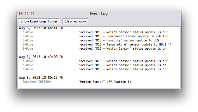

Click the Clear Window button to clear the log entries. Click on Show Event Logs Folder to open the Logs folder in the Finder. Here you will find one file for each day's events. You can change how many day's worth of event log files are stored by selecting Indigo 6→Preferences… and then selecting the General tab. There, you can enter the number of days of event log files that you want to keep. Indigo Server will delete all files outside that period of time.

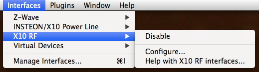

Enable/Disable - toggles the interface on and offConfigure… - opens the configuration preferences for this interfaceHelp with X10 RF Interfaces… - opens a browser to the documentation for configuring this type of interface.
Enable/Disable - toggles the interface on and offReload - will cause the interface to restartHelp with Virtual Devices… - opens a browser window to the documentation page for Virtual Devices.Update Device Group Saved States… - will allow you to update the stored states for each device in the specified Device Group.Toggle Debugging - toggles debugging information in the Event Log on and off. Used primarily for technical support.
Selecting the Interfaces→Manage Interfaces… menu item will open the interface preferences dialog.

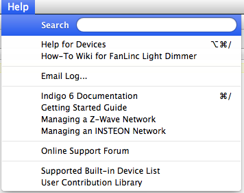

Help for XXXX - this will change slightly based on what window is selected and what's selected in that window - but it will open the default browser to the page in the help documentation for that particular itemHow-To Wiki - this will also change slightly based on what's selected - it will open to the How-To wiki for the selected item (if a device is selected it will go to the wiki for that device, otherwise it will just go to the landing page)Email Log… - this option will email some of your event log data to the specified email address. Particularly useful for technical supportIndigo 6 Documentation - this will open your browser to the landing page for all Indigo 6 documentationGetting Started Guide - this will open your browser to the Getting Started Guide, the place where everyone new to Indigo should startManaging a Z-Wave Network - opens a browser window to the Managing Your Z-Wave Network document in our Documentation wikiManaging an INSTEON Network - opens a browser window to the Managing Your INSTEON Network document in our Documentation wikiOnline Support Forum - this will open your browser to our support forum - it's very active and is the primary place where you should seek help - we answer questions there very quickly and in fact we have many helpful users that can help as wellSupported Built-in Device List - opens a browser window on our new Supported Devices web application that shows which devices and interfaces have been tested with IndigoUser Contribution Library - this will open your browser to our file library - where anyone can contribute apps, images, scripts, plugins, etc. that others may find usefulZ-Wave® is a registered trademark of Sigma Designs, Inc. Indigo's support of Z-Wave hardware is neither endorsed nor certified by Sigma Designs.
