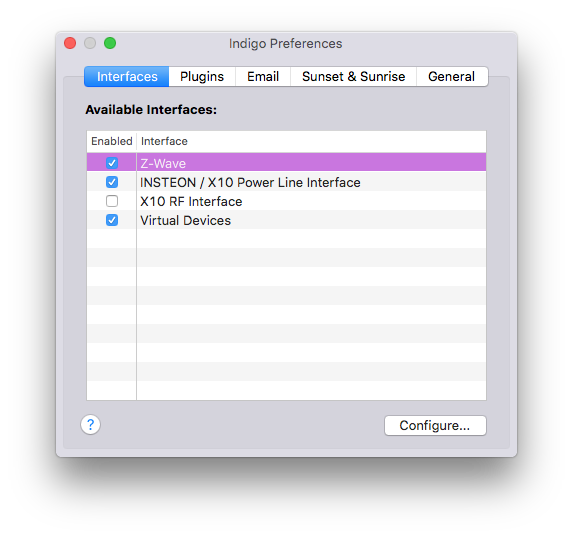

Interfaces Menu Image
Interfaces Tab Image

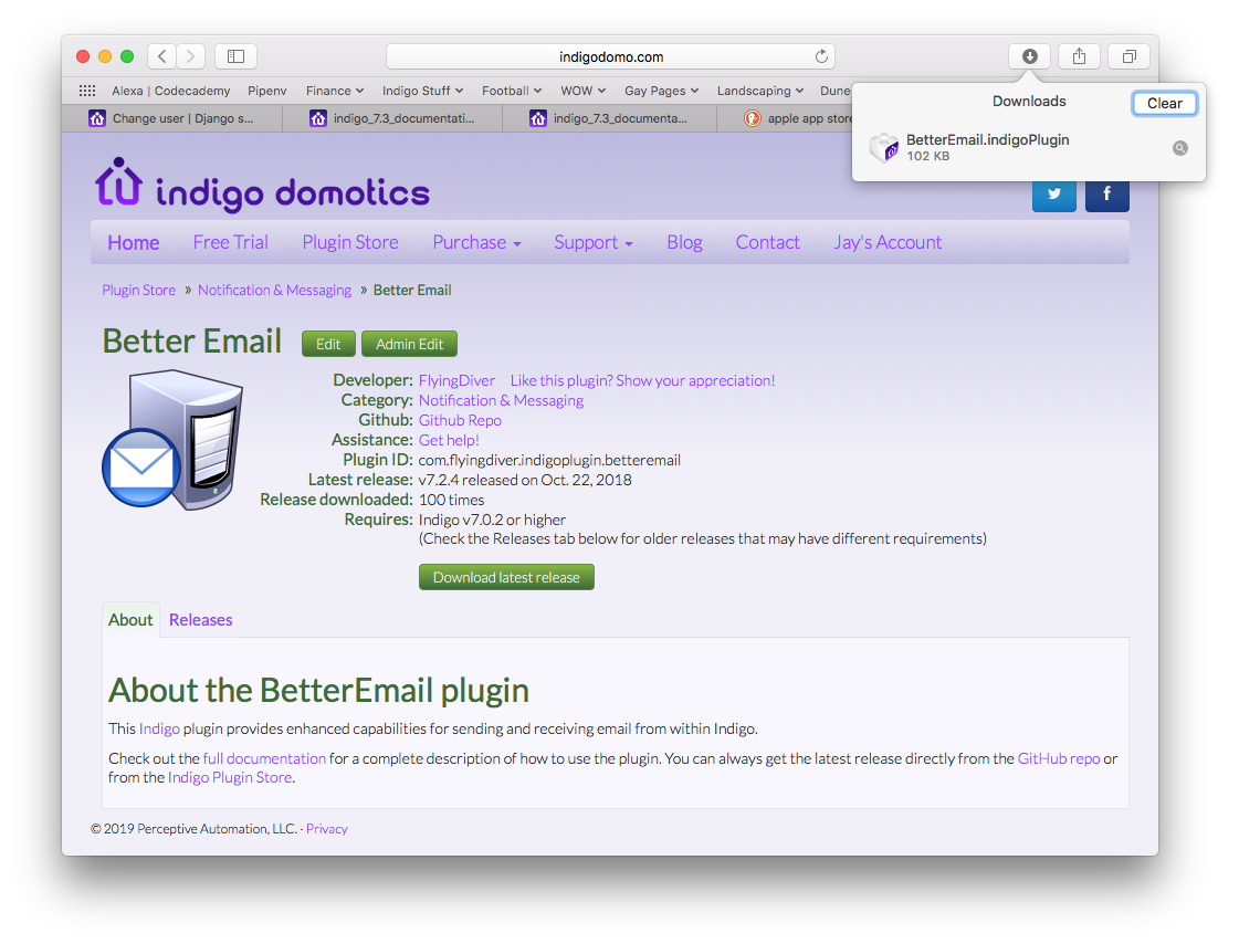

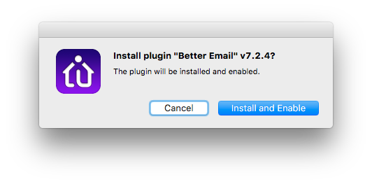

Installing Plugins
  2. Make sure that the plugin is supported by Indigo 7.2 (look for the Requires field).
  10. Done!

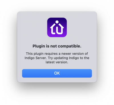

Note if you see the error alert below that the “Plugin is not compatible” then the version of the plugin you installed is too new to run with your Indigo Server version. In this case the best solution is to upgrade your version of Indigo Server.

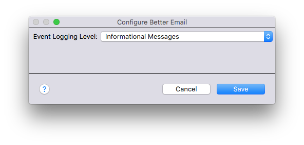

Plugin Configuration
Plugin Configuration Dialog Image

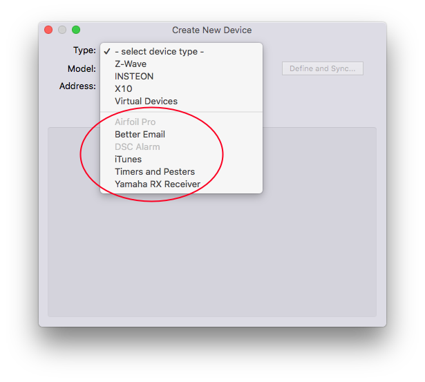

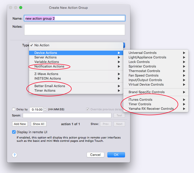

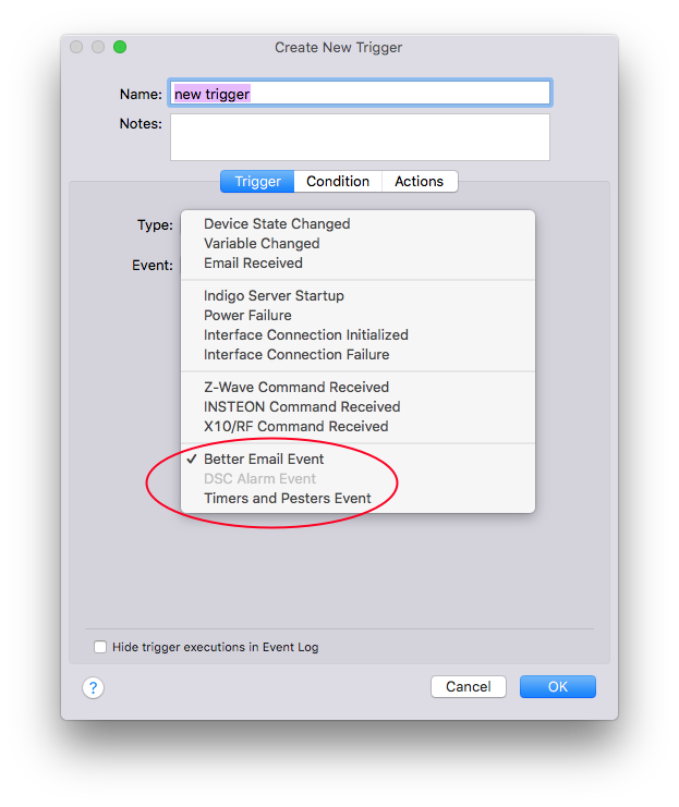

Other Menus with Plugin Items
Plugin New Device Image
Plugin Events Image
Plugin Actions Image

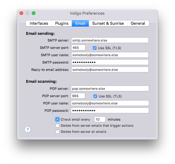

Typically, ISPs or other email service providers allow multiple email addresses for each customer. We recommend that you create a new email address specifically for Indigo, such as [email protected]. Using a separate email address for Indigo will eliminate the possibility that Indigo might trigger an action from a personal email not intended for Indigo, and will allow you to use the Delete from server options shown below to reduce mailbox clutter.
Email Tab Image
To configure email sending
  1. Choose Indigo 7→Preferences… menu item, then make sure the Email tab is selected.
To configure email scanning

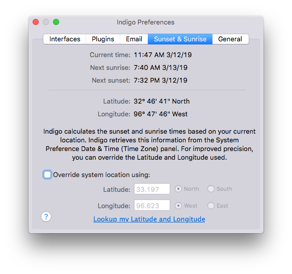

Longitude Latitude Tab Image

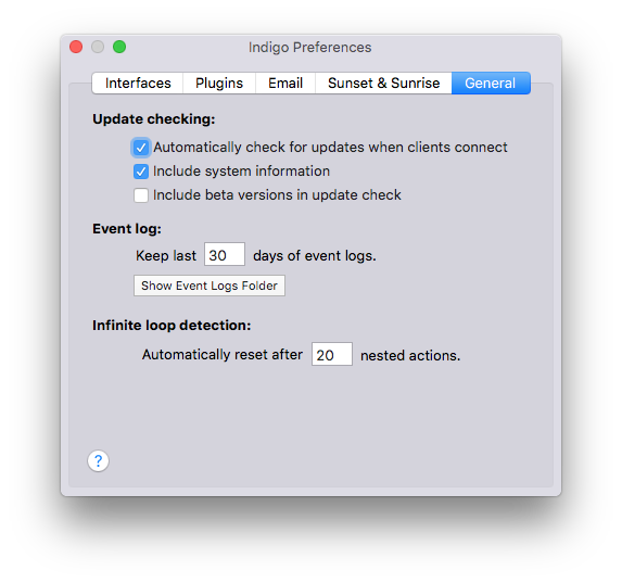

You can configure other Indigo settings by opening the preferences dialog (selecting the Indigo 7→Preferences… menu item) and clicking on the General tab.
You can have Indigo check for updates immediately by selecting the Indigo 7→Check for Updates… menu item.
