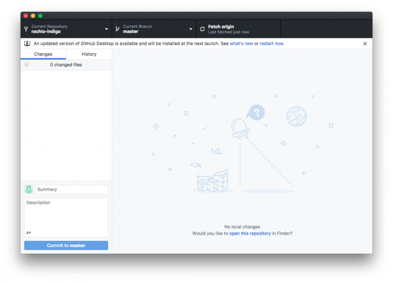

So, you don't have any outstanding changes to the repo, so the UI is pretty empty. Click the open this repository link in the lower part of the window to open the folder in the Finder.

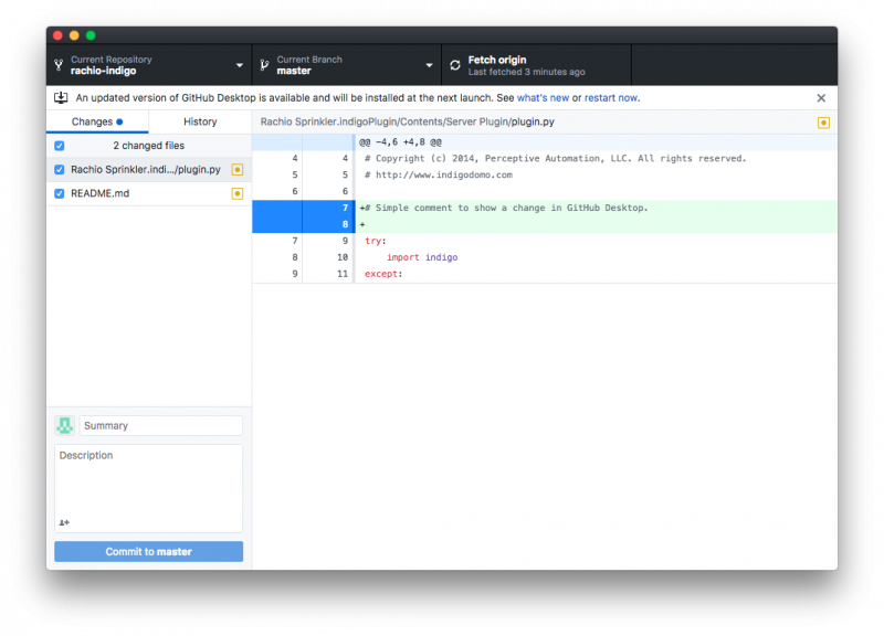

At this point, you're ready to edit and test your changes. We'll leave that process up to you since it'll be heavily dependent on how you do your development. Once you're happy with your changes, when you switch back to GitHub Desktop it'll show something like this:
GitHub Desktop Open Repo Image

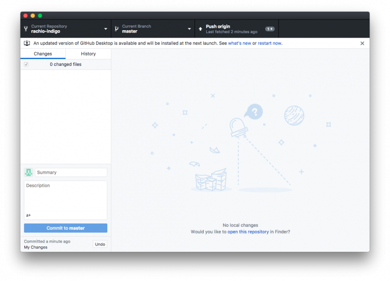

Notice the two changes listed in the left column: for you, this will list any files that you've made changes to and the area on the right side will show what the selected changes are. When you're ready to check the changes in (to your local Git repo), enter a summary and description of the changes and click the Commit to master button in the lower left side. After that, your changes have been made in your local copy of the repository and you'll see something like this:
GitHub Desktop Commit to Master Image
Notice that it no longer shows outstanding changes - because there aren't any. You've checked them in (if you switch to History you'll see them there). What you may notice is that the upper right has changed to a Push origin button. This will push your changes up to the forked repository in your GitHub account. Click that button (it'll switch back to Fetch origin when it's finished). If you switch back to the repo in your GitHub account, you should see:

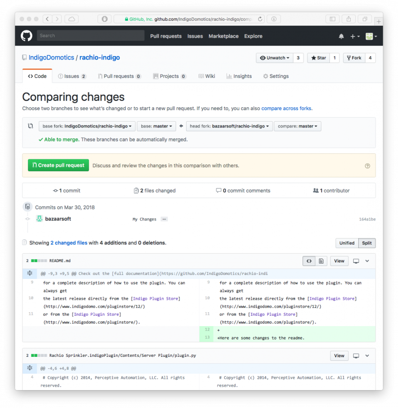

The final step is to tell the owner of the repository that you have some changes you'd like to add to the main plugin repository. Click the New pull request button above the file list. You'll see this:
GitHub Desktop New Pull Request Image
Tons of stuff on that page, including all the changes made to all the files. Click the Create pull request button, fill out the form with a summary and details of your change(s). Click the Create pull request below the form. That will submit the pull request to the owner of the original plugin repo and they'll be able to accept the changes or get back to you with comments.
