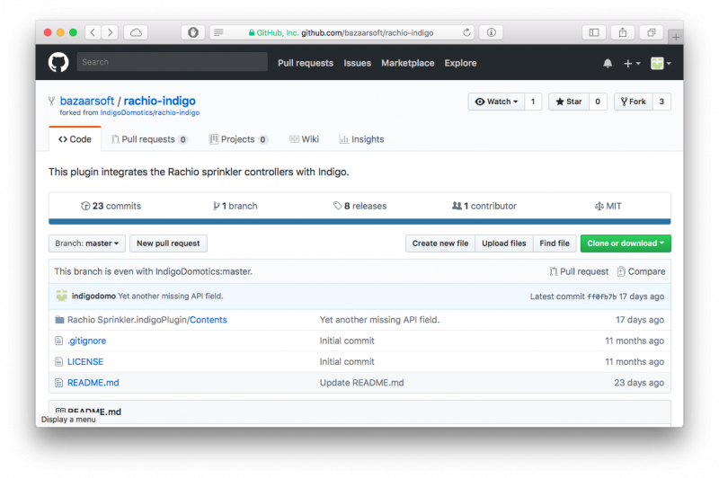

Once logged in to GitHub, find the repository you're interested in and fork it into your account. You do that by clicking the Fork button (as of this writing it was in the upper right corner). For instance, if you wanted to fork the Rachio Sprinkler plugin, you'd see this:
and you'd click the Fork button. After a brief in progress page, you should see something similar this:
This is showing that you now have a fork, or your own copy, of the repository. You can make changes to this copy all you want and it won't affect the original repository.

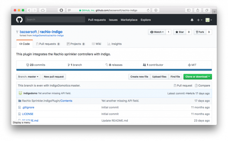

Notice that it no longer shows outstanding changes - because there aren't any. You've checked them in (if you switch to History you'll see them there). What you may notice is that the upper right has changed to a Push origin button. This will push your changes up to the forked repository in your GitHub account. Click that button (it'll switch back to Fetch origin when it's finished). If you switch back to the repo in your GitHub account, you should see:
You'll notice that the top line above the file list will show the commit that you made in GitHub Desktop.

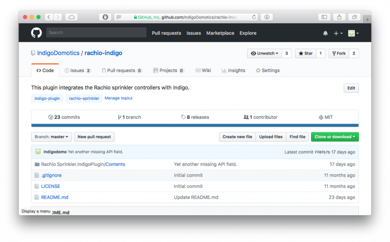

The final step is to tell the owner of the repository that you have some changes you'd like to add to the main plugin repository. Click the New pull request button above the file list. You'll see this:
Tons of stuff on that page, including all the changes made to all the files. Click the Create pull request button, fill out the form with a summary and details of your change(s). Click the Create pull request below the form. That will submit the pull request to the owner of the original plugin repo and they'll be able to accept the changes or get back to you with comments.
