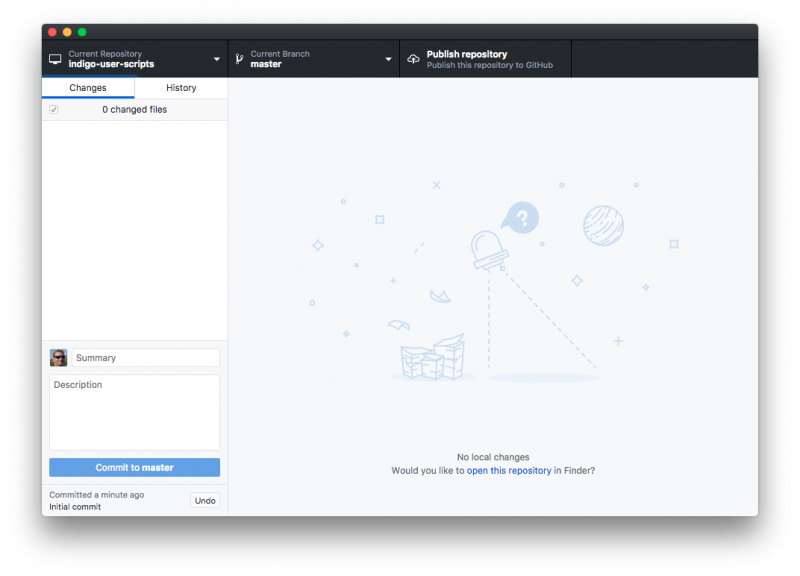

Click the Create Repository button and you'll see your repository's Git status:
GitHub Desktop New Repo Image
What that repo shows are outstanding changes you've made to the files in the repository since the last time you committed any. Committing a change (often referred to as checking in) just tells Git that it should remember the changes you've made (and, in the case of GitHub, what changes it needs to push up to your GitHub account so others can see them).
You haven't made any changes yet, so the list of changed files is 0. If you open the repository folder in the Finder, this is what you'd see:
GitHub Finder Repo New Image
There you see the License file that contains the license you selected (it may be missing if you didn't specify a license). The other file you see is the README.md that you instructed Git to create for you (there are also some hidden files in there as well but you don't really need to know about those).
