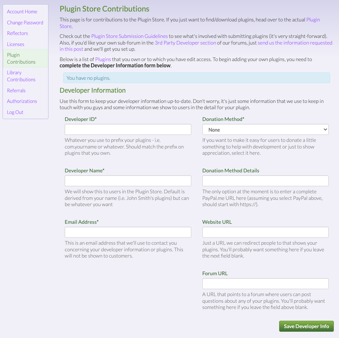

If you haven't already, you'll need to go to the Plugin Contributions page in your Indigo Account and add your developer information:
Plugin Contributions Image
Please read through the entire top section of that page as it contains important information.
Warning: please do not use com.indigodomo or com.perceptiveautomation as your developer ID (or embed those in your developer id). Those are our internal IDs and should not be used.
First and foremost: please do not attempt to add a plugin that you don't “own.” If a developer of a plugin has abandoned it and you would like to take it over, please let us know and we'll take it from there (we've done this in the past and it's usually not a problem). Once we get permission we'll let you know and we can coordinate from there. If the developer is still active, let them know that you'd like to see it in the Plugin Store.

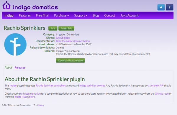

Rachio Plugin Store Detail Image
Markdown in the README.md file will be rendered correctly in the Plugin Store though you can also use a plain text file (README.txt).

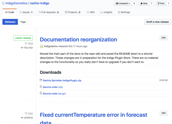

GitHub Releases
When you are ready to publicly release a version of the plugin (either initially or a follow-up release), you should add a release in GitHub:
GitHub Releases Image
We do not look at the “master branch” (or “tips”) of the repo. Only published releases (not pre-releases) will be added to the Plugin Store's release list (see Adding a GitHub Release below for details). The Plugin Store currently doesn't support listing betas (pre-releases) but you can still create them and point your beta testers to them on GitHub (one of the advantages to using GitHub).
Release Requirements
There are a few requirements for GitHub releases:
  • The GitHub release tag # must match PluginVersion in Info.plist file, otherwise the release will be rejected when added to the Plugin Store. Note: we will be looking in the source code zipball from the release for the Info.plist, not the attached plugin. If you're getting the mismatch error, that's where you'll need to look to fix any mismatching version numbers.
  • The README.md or README.txt file must be at the top level of the archive for it to automatically be used. This is to avoid issues if your plugin includes other source projects that may also have their own README files.
  • Although optional, we strongly encourage you to add a zipped version of just the plugin folder (not the entire repo) to each release. Make sure that 'indigoPlugin' is in the name and that it's a zip file (i.e. MyPlugin.indigoPlugin.zip) and make sure that there aren't any other zip files attached to the release. If you don't include an attached zipped plugin, the user will download a zipped copy of the repo itself, including the plugin, the README, etc. (basically everything in the repo). This may make it confusing for users to find and install the plugin.

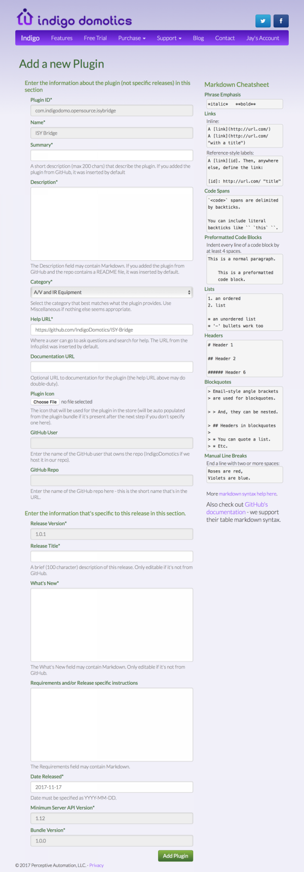

Adding a Directly Managed Plugin
To add a new plugin from an existing zipped plugin, just click the Choose File button and select the file. Note that Safari will automatically zip plugin folders before uploading (but your browser of choice may not).
Click the Next button and you'll see the following page (with the appropriate data pre-populated):
Add Plugin From File Image
This form has a variety of fields (some read-only) that fall into two groups. The first group are fields about the plugin itself (not any specific release of the plugin):
  1. Plugin ID - the ID from the Info.plist file (read-only).
  2. Name - the name from the Info.plist file (read-only).
  3. Summary* - a very brief (200 character) summary of your plugin.
  4. Description* - a full description of what your plugin does. The field may contain Markdown.
  5. Category - the major category of your plugin. If you can't find one that seems suitable, then select Miscellaneous.
  6. Help URL* - the help URL pre-populated from the Info.plist. You may override it and it will never be overwritten automatically. Commonly developers use this URL to point to a specific post on their own sub-forum.
  7. Documentation URL - a separate and optional URL that can point to more comprehensive documentation. So if you have a forum post that contains the documentation for the plugin for instance (and if it's different than the Help URL) then this is the place to put it.
  8. Plugin Icon - if your plugin's bundle has an icon (at Contents/Resources/icon.png) then it will automatically be used if you leave this field blank. Alternately, you can add a PNG file here that will be used in the plugin's display in the Plugin Store.
  9. GitHub User and Repo - disabled since this plugin will be managed directly through our pages.
And the next section is specific information about the release that you're adding:
  1. Release Version - automatically retrieved from the Info.plist file.
  2. Release Title* - a short summary (100 characters max) of this release of the plugin.
  3. What's New* - a full description of the release. This field may contain Markdown.
  4. Requirements - an optional separate field that may contain Markdown. The intention of this field is to outline any specific requirements or steps needed to perform for this release. You may, of course, just add it to the What's New section and leave this field blank. We won't show it if it's blank.
  5. Date Released - the release date defaulting to today. You can change it here if you like, using the YYYY-MM-DD format. Note, if you change it to some date in the future it won't show up in the Plugin Store until that date.
  6. Server API and Bundle Versions - retrieved from the Info.plist and just shown here for completeness. The Server API version is particularly important in that it determines what's shown as the minimum Indigo version required to use the plugin.
Required fields are marked with an asterisk (*). Once you've filled out the form hit Add Plugin.

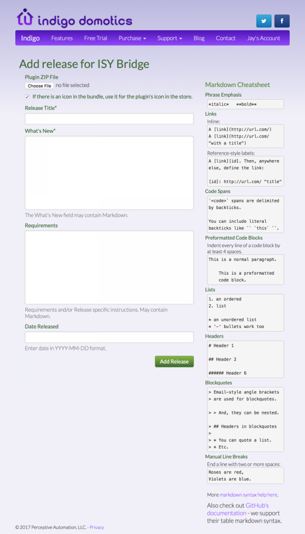

Adding a Release for a Directly Managed Plugin
Adding a new release this way isn't really very hard either, there are just a few fields you need to fill out:
Add Plugin Release File Image
  1. Plugin ZIP File - click the Choose File button and select the plugin folder. Note that Safari will automatically zip plugin folders before uploading (but your browser of choice may not).
  2. If there is an icon in the bundle, use it for the plugin's icon in the Plugin Store - if checked then the icon in the bundle will replace the icon currently being used.
  3. Release Title* - a short summary (100 characters max) of this release of the plugin.
  4. What's New* - a full release description. This field may contain Markdown.
  5. Requirements - an optional separate field that may contain Markdown. The intention of this field is to outline any specific requirements or steps needed to perform for this release. You may, of course, just add it to the What's New section and leave this field blank. We won't show it if it's blank.
  6. Date Released - the release date defaulting to today. You can change it here if you like, using the YYYY-MM-DD format. Note, if you change it to some date in the future it won't show up in the Plugin Store until that date.
Required fields are marked with an asterisk (*). Once you've filled out the form hit Add Release.
You'll notice that on the right side of the screen we've provided a quick cheatsheet for Markdown syntax. This will be helpful when editing any fields that allow Markdown.
