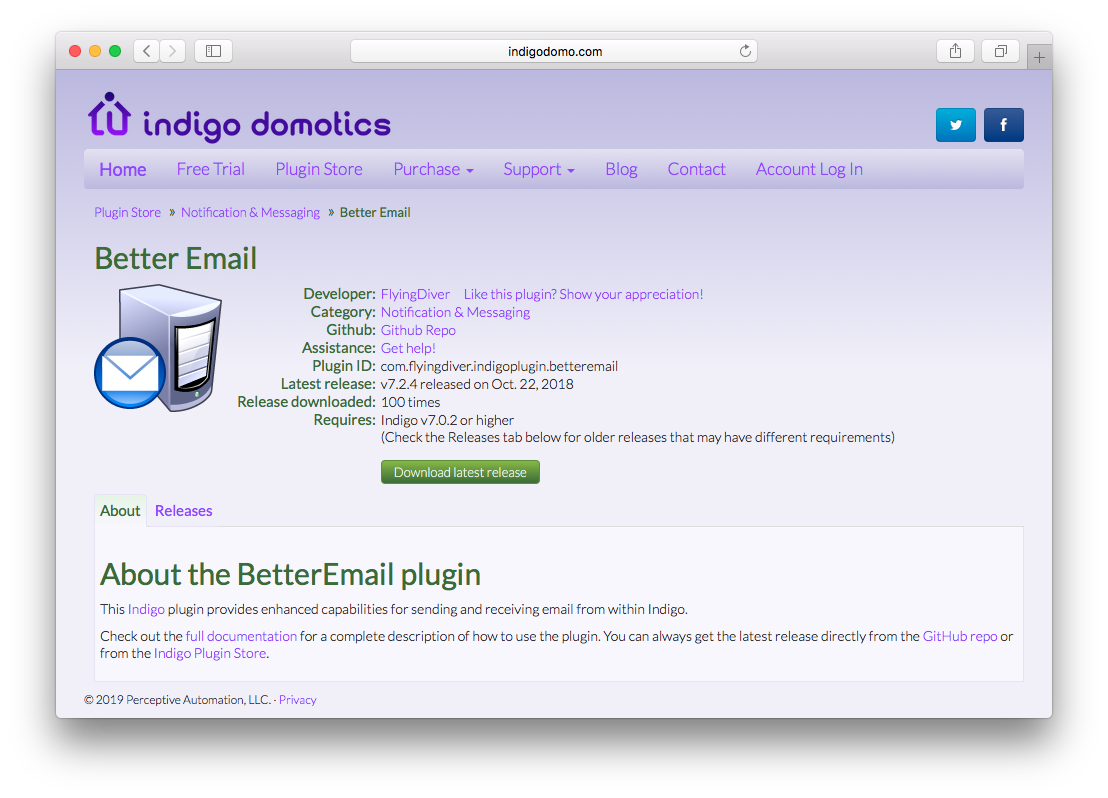

  2. Make sure that the plugin is supported by Indigo 7.2 (look for the Requires field).
  10. Done!
Incompatible Plugins
Note if you see the error alert below that the “Plugin is not compatible” then the version of the plugin you installed is too new to run with your Indigo Server version. In this case the best solution is to upgrade your version of Indigo Server.

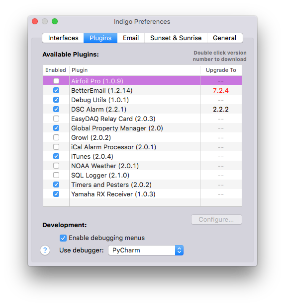

Plugin Configuration
Plugin Configuration Dialog

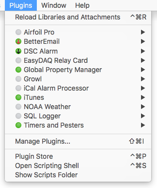

Main Plugins Menu
Plugins Menu Image
Individual Plugin Submenu
Plugin Enabled Submenu Image

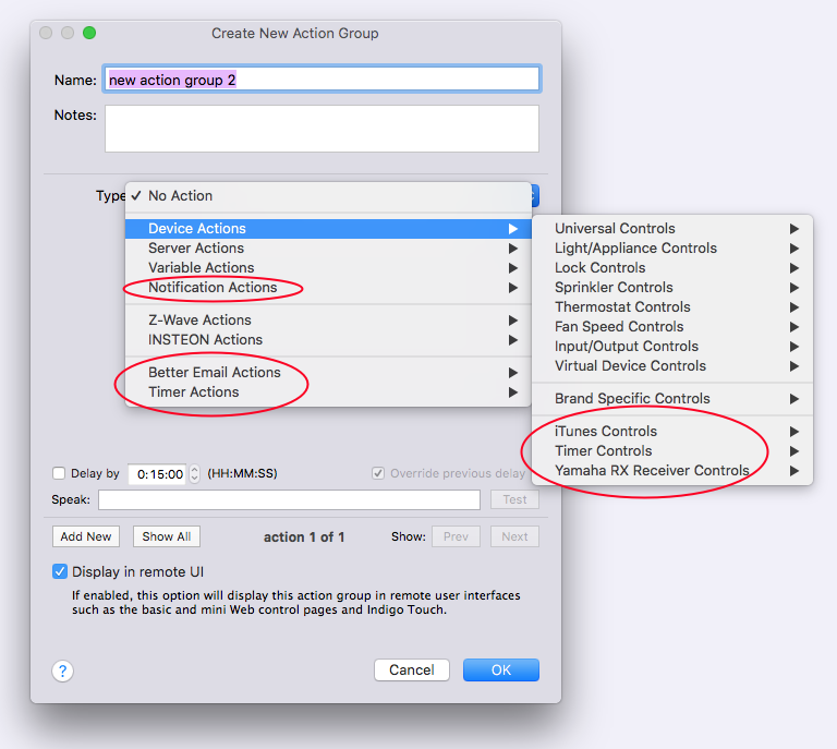

The next section contains:
Other Menus with Plugin Items
Plugin New Device Image
Plugin Events Image
Plugin Actions Image

You can also enable/disable a plugin and download a new plugin version from the Plugins tab in the Indigo Preferences. You open the config window choosing the Indigo 7→Preferences… menu item and clicking the Plugins tab or by selecting the Plugins→Manage Plugins… menu item discussed above.

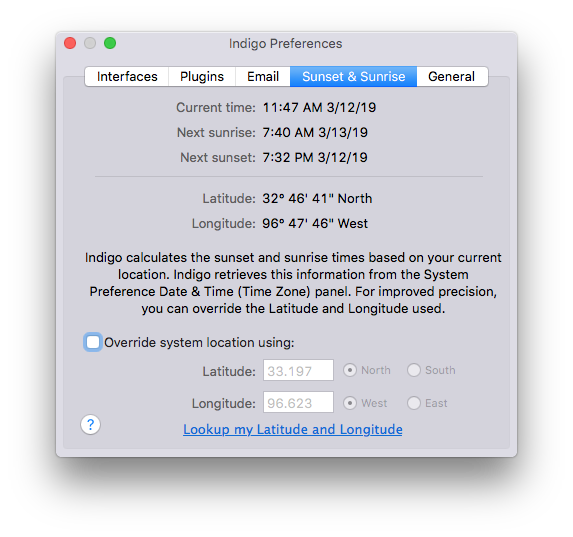

Longitude Latitude Tab Image
  • Choose the Indigo 2021.1→Preferences… menu item, then make sure the Sunset & Sunrise tab is selected.

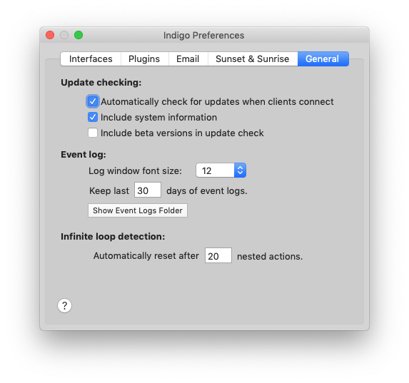

General Preferences Tab Image
You can configure other Indigo settings by opening the preferences dialog (selecting the Indigo 7→Preferences… menu item) and clicking on the General tab.
You can have Indigo check for updates immediately by selecting the Indigo 7→Check for Updates… menu item.
