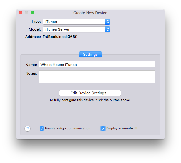

The iTunes Plugin allows you to create iTunes Server devices. To create a new one, switch to the device view and click the New… button. This will bring up the device edit dialog:
iTunes Device Dialog
As shown above, select Plugin from the Type: popup. Select iTunes Plugin from the Plugin: popup, and select iTunes Server from the Model: popup. Click on the Edit Device Settings… button and you'll see the iTunes Device Config UI:
Configure Device Dialog Image

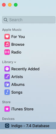

If you're using the Music app (macOS Catalina 10.15.2 or above) that replaced iTunes, you'll see a line in the outline view on the left under Devices named “Indigo - [YOUR DATABASE NAME HERE]”. Select that item.
Music Outline View Image

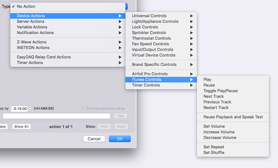

iTunes Actions Menu Image
  • Play - start iTunes playing
  • Pause - pause iTunes
  • Pause iTunes and Say - pause iTunes (if it's running) and speak the supplied text. Restart only if it was paused to begin with.\\iTunes Pause and Say Dialog Image
NOTE: you can use the special variable substitution fields in the Pause iTunes and Say text field - see Variable Substitution for more information.
