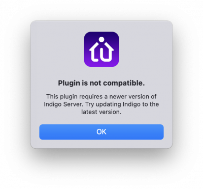

Incompatible Plugins
Note if you see the error alert below that the “Plugin is not compatible” then the version of the plugin you installed is too new to run with your Indigo Server version. In this case the best solution is to upgrade your version of Indigo Server.

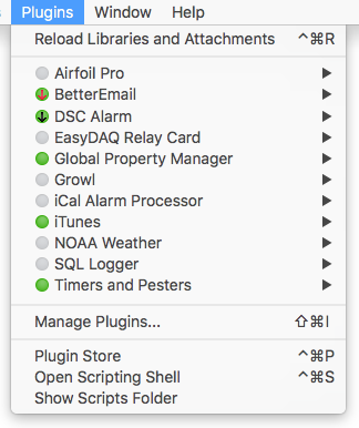

Main Plugins Menu
Plugins Menu Image
Individual Plugin Submenu
Plugin Enabled Submenu Image
