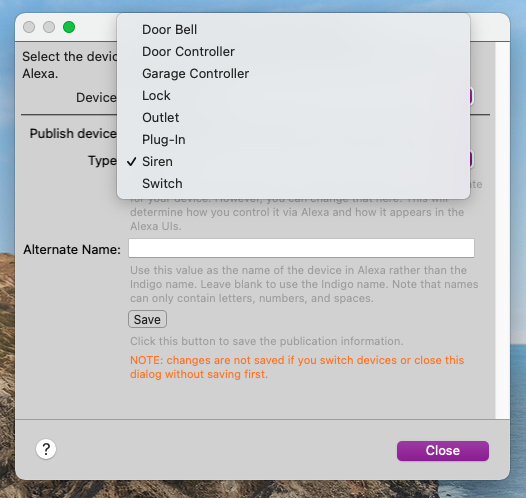

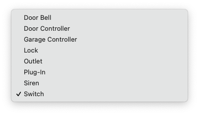

Alexa Relay Subtypes Image
The options are:
    • Alexa, open the front door
    • Alexa, open the garage door
    • Alexa, lock the back door
    • Alexa turn off desk lamp

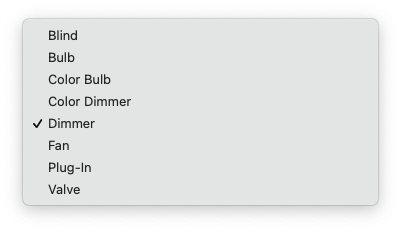

Alexa Dimmer Subtypes Image
The options are:
    • Alexa, close the shades
    • Alexa, ceiling fan speed
    • Alexa, turn off ceiling fan
    • Alexa, turn off the valve

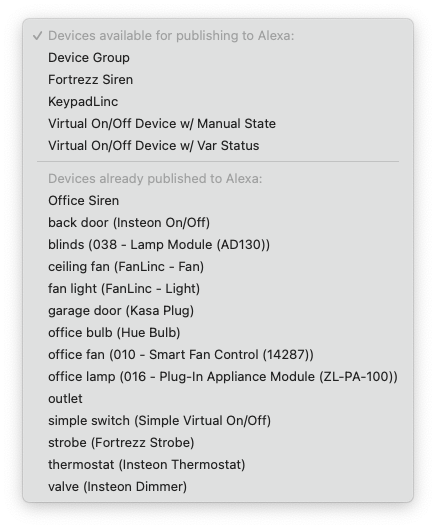

Showing Publications
 Alexa                           Currently published devices (Alexa name first if different than Indigo name):
 Alexa                             'Office Siren' ('Office Siren') - Type: RelayDevice - Subtype: Siren
 Alexa                             'automatic door' ('automatic door') - Type: RelayDevice - Subtype: Door Controller
 Alexa                             'back door' ('Insteon On/Off') - Type: RelayDevice - Subtype: Lock
 Alexa                             'blinds' ('038 - Lamp Module (AD130)') - Type: DimmerDevice - Subtype: Blind
 Alexa                             'ceiling fan' ('FanLinc - Fan') - Type: SpeedControlDevice - Subtype: None
 Alexa                             'fan light' ('FanLinc - Light') - Type: DimmerDevice - Subtype: Dimmer
 Alexa                             'garage door' ('Kasa Plug') - Type: RelayDevice - Subtype: Garage Controller
 Alexa                             'office bulb' ('Hue Bulb') - Type: DimmerDevice - Subtype: Color Bulb
 Alexa                             'office fan' ('010 - Smart Fan Control (14287)') - Type: DimmerDevice - Subtype: Fan
 Alexa                             'office lamp' ('016 - Plug-In Appliance Module (ZL-PA-100)') - Type: RelayDevice - Subtype: Plug-In
 Alexa                             'outlet' ('outlet') - Type: RelayDevice - Subtype: Outlet
 Alexa                             'simple switch' ('Simple Virtual On/Off') - Type: RelayDevice - Subtype: Switch
 Alexa                             'strobe' ('Fortrezz Strobe') - Type: RelayDevice - Subtype: Plug-In
 Alexa                             'thermostat' ('Insteon Thermostat') - Type: ThermostatDevice - Subtype: None
 Alexa                             'valve' ('Insteon Dimmer') - Type: DimmerDevice - Subtype: Valve

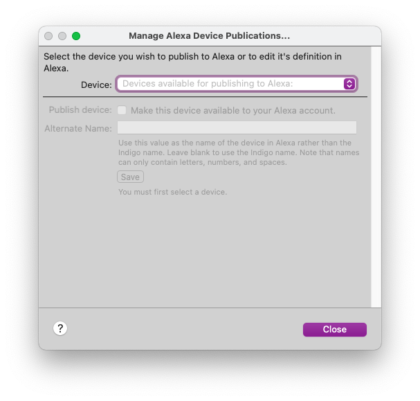

Full Switch
  4. Once you have all your devices published, you can confirm that they are all published by selecting the Plugins→Alexa→Show Device Publications menu item and it will print the list of publications in the Event Log window.
  5. In the Alexa app, website, or using an Alexa enabled device, click/touch the Discover button or say “discover devices”.
   Alexa                           Alexa discovery request received, assembling reply...
Partial Switch
  4. In the Alexa app, website, or using an Alexa enabled device, click/touch the Discover button or say “discover devices”.
Changing the Indigo Name
Changing the Device Type
  3. Save any changes.
  4. Rerun discovery in Alexa.
