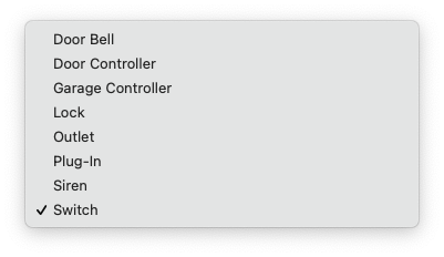

The options are:
- Door Bell - as of this release, this will only allow you to turn on/off the doorbell, not accept ring events. We will look at adding that in a future release.
- Door Controller - if you have a device that physically operates a door (but not a garage door), you can use this device type. You can then say things like:
- Alexa, open the front door
- Alexa, what's the status of the front door
- Garage Controller - this is exactly what you think it is. You will be able to open/close (raise/lower) your garage door. Alexa uses this control type as a more secure option. When Alexa first discovers a garage door, it will not allow you to control the door by voice. Rather, it will tell you to control it manually or go to the Alexa app and configure the door for use with voice control. In the settings for the door in the Alexa app, you will be able to enter a 4 digit PIN for extra security. When you ask Alexa to open or raise the door, you will be prompted for your PIN code. If you have an automatic door controller (specified above) and want the extra security of a PIN code, you can select Garage Controller as well and it should work just like a garage door. PIN codes are set per device so each can be different. You can say things like:
- Alexa, open the garage door
- Alexa, is the garage door open
- Lock - similar to a garage door, a lock device will need to have a PIN assigned for it in the Alexa app. Once that's done, when you attempt to unlock the door (Alexa, unlock the back door), it will prompt you for the PIN. You can say things like:
- Alexa, lock the back door
- Alexa, is the back door locked
- All the rest of the types will simply respond to standard on/off commands. There is currently no distinction other than the icon that shows up in the Alexa app. You can say things like:
- Alexa, turn on bathroom exhaust fan
- Alexa turn off desk lamp

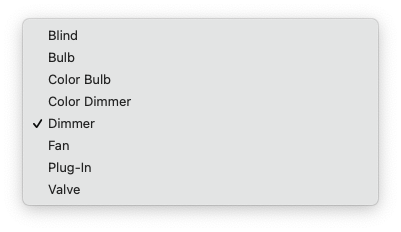

The options are:
Blind- use this type if your dimmer device actually controls blinds, shades, or drapes. You can say things like:- Alexa, raise the blinds to twenty-five percent
- Alexa, set the drapes to fifty percent
- Alexa, close the shades
- Alexa, what is the status of the shades
Fan- use this type if your device actually controls a fan (as of this release Z-Wave fan controllers are treated as dimmers in Indigo). Fan devices from Indigo in Alexa will support 4 modes: Off, Low, Medium, High. You can say things like:- Alexa, set ceiling fan to medium
- Alexa, set ceiling fan to highest
- Alexa, ceiling fan speed
- Alexa, turn off ceiling fan
Valve- use this type if your device controls a valve, or really any device that has a 0-100% range. You can say things like:- Alexa, set set the valve to thirty percent
- Alexa, increase valve by ten percent
- Alexa, turn off the valve
- All the rest will support standard on/off and dim/brighten. If the device supports color and/or white color temperature, those commands will be added to the standard on/off and dim/brighten commands (see the examples above). There is currently no distinction other than the icon that shows up in the Alexa app.

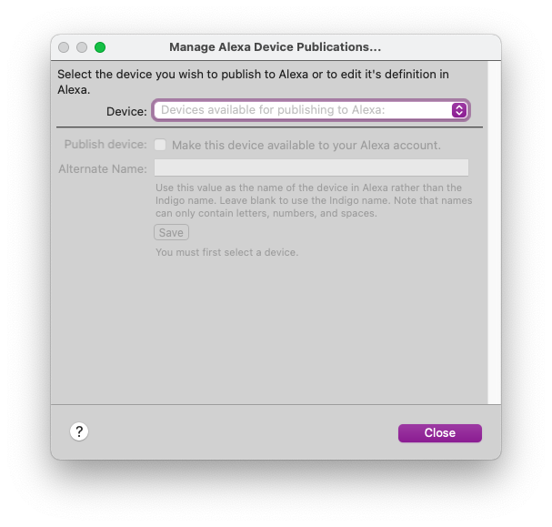

Alexa Plugin operations
Plugin Startup
Started plugin "Alexa 2021.2.0" Alexa Finding devices to publish to Alexa... Alexa ... '010 - Smart Fan Control (14287)' published as 'office fan' Alexa ... '016 - Plug-In Appliance Module (ZL-PA-100)' published as 'office lamp' Alexa ... '038 - Lamp Module (AD130)' published as 'blinds' Alexa ... 'automatic door' published Alexa ... 'FanLinc - Fan' published as 'ceiling fan' Alexa ... 'FanLinc - Light' published as 'fan light' Alexa ... 'Fortrezz Strobe' published as 'strobe' Alexa ... 'Hue Bulb' published as 'office bulb' Alexa ... 'Insteon Dimmer' published as 'valve' Alexa ... 'Insteon On/Off' published as 'back door' Alexa ... 'Insteon Thermostat' published as 'thermostat' Alexa ... 'Kasa Plug' published as 'garage door' Alexa ... 'Office Siren' published Alexa ... 'outlet' published Alexa ... 'Simple Virtual On/Off' published as 'simple switch' Alexa A total of 15 devices are currently published to Alexa Alexa Warning If you can't control a device, rerun discover from your Alexa device.

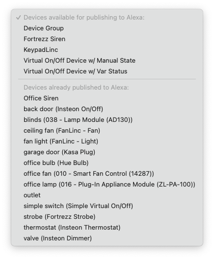

Showing Publications
Alexa Currently published devices (Alexa name first if different than Indigo name):
Alexa 'Office Siren' ('Office Siren') - Type: RelayDevice - Subtype: Siren
Alexa 'automatic door' ('automatic door') - Type: RelayDevice - Subtype: Door Controller
Alexa 'back door' ('Insteon On/Off') - Type: RelayDevice - Subtype: Lock
Alexa 'blinds' ('038 - Lamp Module (AD130)') - Type: DimmerDevice - Subtype: Blind
Alexa 'ceiling fan' ('FanLinc - Fan') - Type: SpeedControlDevice - Subtype: None
Alexa 'fan light' ('FanLinc - Light') - Type: DimmerDevice - Subtype: Dimmer
Alexa 'garage door' ('Kasa Plug') - Type: RelayDevice - Subtype: Garage Controller
Alexa 'office bulb' ('Hue Bulb') - Type: DimmerDevice - Subtype: Color Bulb
Alexa 'office fan' ('010 - Smart Fan Control (14287)') - Type: DimmerDevice - Subtype: Fan
Alexa 'office lamp' ('016 - Plug-In Appliance Module (ZL-PA-100)') - Type: RelayDevice - Subtype: Plug-In
Alexa 'outlet' ('outlet') - Type: RelayDevice - Subtype: Outlet
Alexa 'simple switch' ('Simple Virtual On/Off') - Type: RelayDevice - Subtype: Switch
Alexa 'strobe' ('Fortrezz Strobe') - Type: RelayDevice - Subtype: Plug-In
Alexa 'thermostat' ('Insteon Thermostat') - Type: ThermostatDevice - Subtype: None
Alexa 'valve' ('Insteon Dimmer') - Type: DimmerDevice - Subtype: Valve

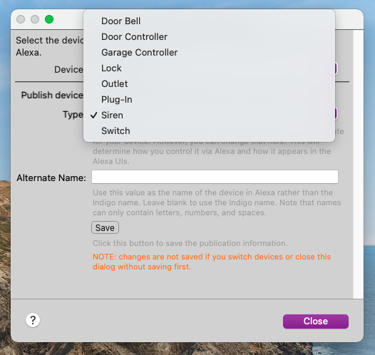

Changing the Indigo Name
Changing the Device Type
- In the Alexa app, remove the device.
- Go back to the Publication Dialog, select the device, and make sure that you are satisfied with the subtype (or change it as necessary).
- Save any changes.
- Rerun discovery in Alexa.
