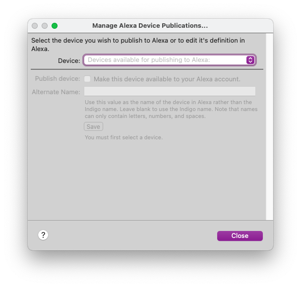

To make a device available to Alexa, you must explicitly publish it. Use thePlugins→Alexa→Manage Device Publications… menu item to open the publication dialog:
In this dialog, you will select a device from the popup. Note that the popup is divided into two sections:
The top part of the list are Indigo devices that can be published to Alexa, but haven't yet. If you select one of these devices, the dialog will show you the appropriate options for that device. For all devices, you can specify an Alternate Name which will be used in Alexa when you operate it (i.e. Alexa, turn on office lamp). If you leave this field blank, the actual Indigo device name will be used. Note that Alexa device names can only contain letters, numbers, and spaces.

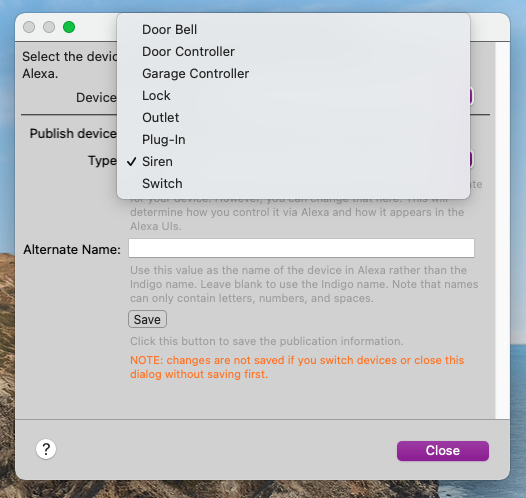

Some devices will also show a Type popup:
You will use this popup to tell Alexa more specifically what kind of device it is. We will attempt to look at various other characteristics of the device to select what we believe is the appropriate type, but you may select any from the list and we will relay that information to Alexa so you can control it using appropriate terminology (see below for specifics).
The bottom part of the list are devices that you have already published to Alexa. If you select one of these devices, you can edit or unpublish the device.
Warning: be sure to click the Save button before moving on or your changes won't be saved. Also, if you make any changes, you will need to rerun discovery from an Alexa device or the Alexa app before those changes will be reflected. As a reminder, you must either click the discover devices button in the Alexa apps or ask “Alexa, discover devices” of an Alexa enabled device.

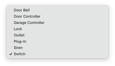

When you select an Indigo device that is a standard On/Off device to publish, you will get a popup that will help us tell Alexa how to control your device:
We will take a guess at what the specific type of the device is, but we won't always guess correctly. For instance, if there isn't anything about your device that Indigo can determine, it will just automatically select Switch. You can override that setting however to make the device best match what it does.
The options are:
  • Door Bell - as of this release, this will only allow you to turn on/off the doorbell, not accept ring events. We will look at adding that in a future release.
  • Door Controller - if you have a device that physically operates a door (but not a garage door), you can use this device type. You can then say things like:
    • Alexa, open the front door
    • Alexa, what's the status of the front door
  • Garage Controller - this is exactly what you think it is. You will be able to open/close (raise/lower) your garage door. Alexa uses this control type as a more secure option. When Alexa first discovers a garage door, it will not allow you to control the door by voice. Rather, it will tell you to control it manually or go to the Alexa app and configure the door for use with voice control. In the settings for the door in the Alexa app, you will be able to enter a 4 digit PIN for extra security. When you ask Alexa to open or raise the door, you will be prompted for your PIN code. If you have an automatic door controller (specified above) and want the extra security of a PIN code, you can select Garage Controller as well and it should work just like a garage door. PIN codes are set per device so each can be different. You can say things like:
    • Alexa, open the garage door
    • Alexa, is the garage door open
  • Lock - similar to a garage door, a lock device will need to have a PIN assigned for it in the Alexa app. Once that's done, when you attempt to unlock the door (Alexa, unlock the back door), it will prompt you for the PIN. You can say things like:
    • Alexa, lock the back door
    • Alexa, is the back door locked
  • All the rest of the types will simply respond to standard on/off commands. There is currently no distinction other than the icon that shows up in the Alexa app. You can say things like:
    • Alexa, turn on bathroom exhaust fan
    • Alexa turn off desk lamp

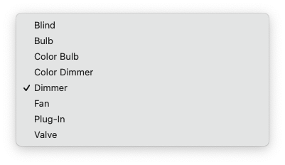

When you select an Indigo device that is a dimmer device to publish, you will get a popup that will help us tell Alexa how to control your device:
We will take a guess at what the specific type of the device is, but we won't always guess correctly. For instance, if there isn't anything about your device that Indigo can determine, it will just automatically select Dimmer. You can override that setting however to make the device best match what it does.
The options are:
  • Blind - use this type if your dimmer device actually controls blinds, shades, or drapes. You can say things like:
    • Alexa, raise the blinds to twenty-five percent
    • Alexa, set the drapes to fifty percent
    • Alexa, close the shades
    • Alexa, what is the status of the shades
  • Fan - use this type if your device actually controls a fan (as of this release Z-Wave fan controllers are treated as dimmers in Indigo). Fan devices from Indigo in Alexa will support 4 modes: Off, Low, Medium, High. You can say things like:
    • Alexa, set ceiling fan to medium
    • Alexa, set ceiling fan to highest
    • Alexa, ceiling fan speed
    • Alexa, turn off ceiling fan
  • Valve - use this type if your device controls a valve, or really any device that has a 0-100% range. You can say things like:
    • Alexa, set set the valve to thirty percent
    • Alexa, increase valve by ten percent
    • Alexa, turn off the valve
  • All the rest will support standard on/off and dim/brighten. If the device supports color and/or white color temperature, those commands will be added to the standard on/off and dim/brighten commands (see the examples above). There is currently no distinction other than the icon that shows up in the Alexa app.
