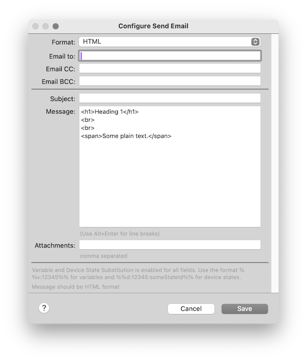

Sending an HTML Email
Send HTML Email Image
When sending an HTML email, it's your responsibility to ensure that the Message field contains a valid HTML document - we don't attempt to validate it. The plugin supports both simple and more complex HTML constructions. For example, a simple HTML message might look like this:
<h1>Heading 1</h1>
<br>
<br>
<span>Some plain text.</span>
