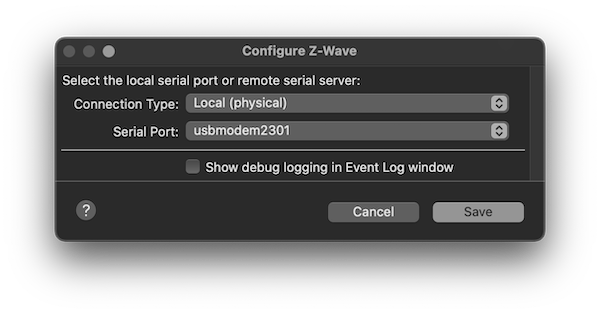

- Choose the
Interfaces→Z-Wave→Enablemenu item. This should cause theConfigure Z-Wavedialog to open automatically (but only the first time you enable Z-Wave - you can select theInterfaces→Z-Wave→Configure…menu item to get back to the configuration dialog later): - The default
Connection TypeofLocal (physical)is correct (assuming you've plugged your Z-Stick directly into your Mac). - On the
Serial Portpopup, you should select the serial port titledSLAB_USBtoUART(for Z-Stick Series 2) or one that starts withusbmodem(for Z-Stick Gen5), depending on which Z-Stick version you have. If you have two serial ports that start withSLAB_USBtoUARTthat means that you have multiple devices that use the Silicon Labs VCP driver - you'll just need to try each one to determine which is the correct port if you don't know beforehand. Unfortunately, that driver doesn't handle multiple devices using the Silicon Labs chip very well, and that number may change when you reboot. - Unless instructed by Perceptive Automation support, you should leave the
Show debug logging of interface communicationcheckbox unchecked. - Save the
Configure Z-Wavedialog.
