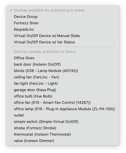

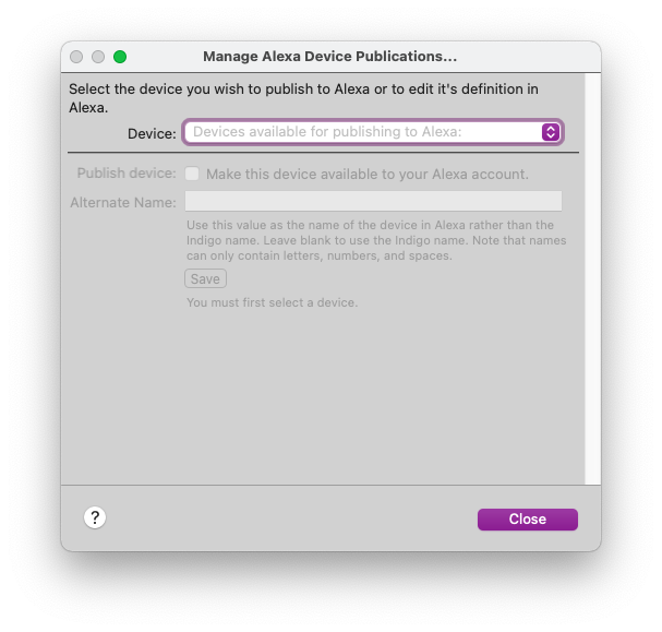

  4. Once you have all your devices published, you can confirm that they are all published by selecting the Plugins→Alexa→Show Device Publications menu item and it will print the list of publications in the Event Log window.
  5. In the Alexa app, website, or using an Alexa enabled device, click/touch the Discover button or say “discover devices”.

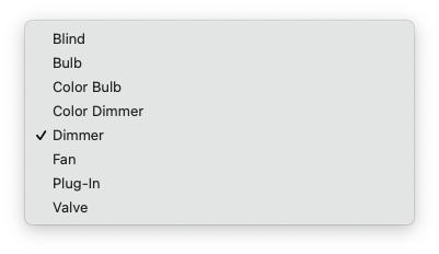

Changing the Indigo Name
Changing the Device Type
  3. Save any changes.
  4. Rerun discovery in Alexa.
