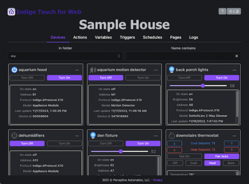

Indigo includes an integrated web server that allows you to serve your own custom content, and it also includes a web-based alternative to Indigo Touch for iOS called Indigo Touch for Web or ITW. ITW is a Single Page Application (SPA) that runs entirely in a browser. ITW is not meant to be a replacement for the Mac Client – you can't configure devices or add variables for example – however, the most common Indigo functions are available. These include turning on/off devices, controlling thermostats, changing variable values and so on. Available features are listed below, and we have plans to include more features in the future!
Indigo Touch Web Image
ITW works by establishing a bidirectional connection to the Indigo Websocket API. ITW works on both desktop and mobile (mobile availability depends on configuration and whether you're connected locally via W-Fi or remotely via cellular).

When ITW loads, you'll be presented with the main view which has five tabs to choose from – Devices, Actions, Variables, Pages and Logs (Indigo schedules are not currently shown in ITW).
Tabs
Devices
  • The Devices tab shows the devices in the Indigo database.
  • Only devices with Remote Display checked will be displayed.
  • Many device controls are available in ITW, including:
    • On/off
    • Lock/unlock
    • Dimming
    • Thermostat
Devices also have a special popup menu which is shown when you click the ellipsis icon at the top of the device tile. This displays a menu with up to four options (depending on the type of device):
  • Copy ID - This item will cause the device's ID to be copied to the clipboard. Due to the security of modern browsers, this feature will only work via https connections via the Indigo Reflector Service and via http when connecting using a local loopback address like localhost or 127.0.0.1.
  • Refresh from server - ITW objects update automatically when data are changed in Indigo, but sometimes you might want to force the data to refresh for a specific device. Selecting this item will cause the device data to be refreshed.
  • Show device JSON - this item will cause a pop-up window to display the entire JSON payload for the device.
