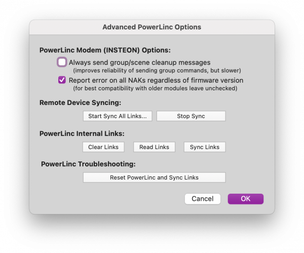

If you click on the Interface Options… button, you'll see something like this:

Resetting your PowerLinc
- In Indigo 5 or above, select the
Interfaces→Insteon/X10 Power Line→Disablemenu item - Unplug your PowerLinc and wait about 15 seconds
- Press and hold the black set button on the side
- While holding the button, plug it back in and continue to hold the button for about 15 seconds
- Release the button
- In Indigo, select the
Interfaces→Insteon/X10 Power Line→Enablemenu item - Select the
Interfaces→Insteon/X10 Power Line→Configure…menu item - Click the
Interface Options…button - Click the
Sync Linksbutton
