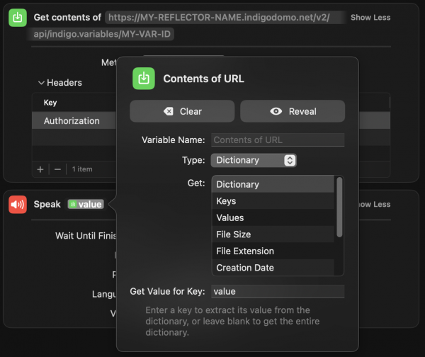

Get a Variable Value

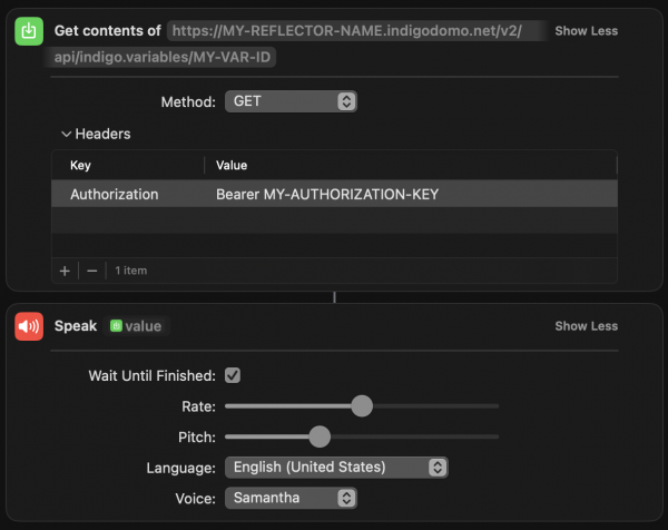

This example shows how to obtain a variable's value and do something with it – in this case, speak the value aloud. The action you take in your shortcut could be any number of things.
Get a Variable Value Image
  • The “trick” to getting the variable's value into the speak action is to tell your shortcut what kind of data it is. To do this, click on Get Contents of URL in the speak action, set the data type to Dictionary, and set Get Value for Key to value (be sure to hit return or tab to get the setting value to stick.)

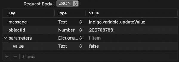

Update a Variable Value
There is currently only one API command for Variables – indigo.variable.updateValue – which requires three payload elements:
    • key: value,

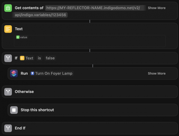

You can include conditions in your shortcuts and take action – or not – based on the condition. For example, turn on a light – but only if it's dark outside.
  • As with the other examples, set up your Get Contents of URL action to get a variable's value – in this example, the built-in variable isDaylight,

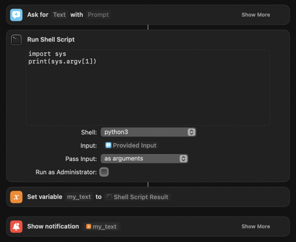

The example below prompts the user for text, passes the text to the script, receives the script's output, and sends that output to a macOS notification. This very basic example is simply to show how to pass input to your script and pass the script's output on to other steps. Note the use of sys.argv[1]. This statement is reading the second argument passed to the script (the first argument is its source–the shortcut itself–which we won't need). The second argument – sys.argv[1] – is passed as a string, and that's the bit we need. You'll need to account for whatever format your inputs and outputs turn out to be. These are the two most important settings to this example:
  1. Shell: Python 3
  2. Pass Input: as arguments
The rest is up to you.

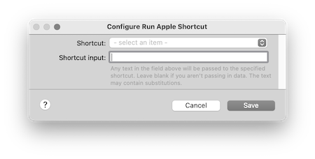

The easiest way to run a shortcut is via an Indigo Action. Create a new Action and select Server Actions > Run Apple Script. You can optionally add text as input to the shortcut if you wish; otherwise, leave the Shortcut Input field blank.
Run Shortcut Action Image

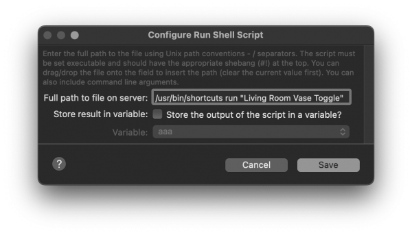

Run from the Command Line
When calling a shortcut from the “Run Shell Script” action, it's best to use the full path to the target: %%/usr/bin/shortcuts%% to make sure Indigo can find it.
Run Shell Script Action

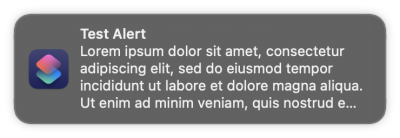

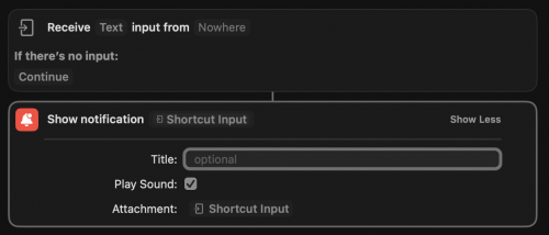

  1. Create your Notification shortcut named “Test Alert”:
  2. Create a new shortcut and add the “Show Notification” action.
  3. For Attachment, select “Shortcut Input”.
  4. Double-click “Shortcut Input” and select Type: Text
External Shell Scripts Image

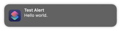

From within Indigo, execute your action. The custom message you sent (in this example, “Hello world.”) will be sent to the script and will appear in the resulting notification.

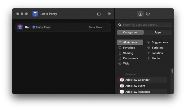

Of course, you can have Siri run your shortcut by saying the name of the shortcut you want to run. To run the Toggle Living Room Lamp shortcut, say, “Hey Siri. Toggle Living Room Lamp”. However, once you begin to have a lot of shortcuts, it can be tough to remember the exact name of every shortcut in your collection. One thing that can help is to create multiple shortcuts with similar names that all point to the same “original” shortcut. That way, if you make a change to the original shortcut, you don't need to change the others (if you change the name of the original shortcut, the Shortcuts app will update the others).
Siri Phrase Action taken
“Party Time” sets lights, temperature, tv, whatever
“Let's Party” Runs Party Time shortcut
“It's Party Time” Runs Party Time shortcut
“I'm Having a Party” Runs Party Time shortcut
